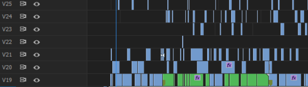

I would do the sound mix first and get that sounding correct, for a concert what you hear dictates which shot to use. If you have one, sync and put the wideshot on V1. Then sync and put the other cameras on higher tracks. Copy these in-sync tracks to V 10 to 15 and turn the tracks off, it is good to have all the material somewhere in case you need it later.  I would then go through each V2 to V5 tracks and cut out the unusable bits, focus problems, re-frames etc. You will then have a checkerboard of usable shots. The editing art now takes over just cut and delete the clips leaving you with the best angles for the music.
This is part of a similar edit I did.
I find keeping similar clips on their own track makes it easier to colour correct

Excellent example, Richard.
