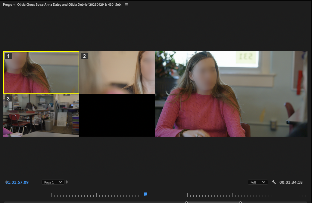

Add fill-frame or Fit-to-frame option for multi-camera view
When multi-camera view is enabled for editing:
- UHD footage,
- using UHD multi-camera source sequence,
- in a 1080 timeline
The Program monitor shows the individual cameras zoomed and cropped, like viewing an UHD clip in a 1080 timeline without scaling to fit or fill frame. IE the multi-camera view does not carry over the effects settings of the multi-camera clip, so even if the multi-camera clip is scaled 50% to fit the 1080 frame the multi-camera view shows a scaled and croped view of the individual angles.
Idea:
add a setting that forces the multi-camera view to fill-frame or Fit-to-frame for individual camera sources
OR
have the mult-cam view apply to the position and scaling attributes for the multi-cam clip to individual camera sources

Thanks again Myer. That is a work around I had not thought of. Another approach that gives the same results is creating the multi-cam source sequence as a 1080 timeline to match the editing timeline and scaling the source clips to 50% within the multi-cam source sequence. That way there is no size mismatch between the editing timeline and the multi-cam. The downside to both methods is that you no longer get to adjust the scale for the multicam clip in a way that reflects the actual size of the underlying source clips. IE even though you are seeing the source clip at 50% its original size, the properties for the multicam clip is showing 100%. So if I want to push-in for a tighter angle, I might go up to 150% - which results in effective scaling of the underlying clip to 75%. I find this annoying, and potentially confusing when there are both 1080 and UHD sources in a project. I like to know when I'm actually at 100% so I know if I have extra resolution to work with.
In any case, I can handle work-arounds, but I'm hoping for a fix from adobe as this seem to me like a problem in the way the multi-cam view displays mismatched frame sizes. To me it seems obvious that they should appear in the multicam view the same way they would appear in the timeline. Maybe I'm the only one.

Hi Myer, thanks for weighing in, but I think you are missing the root of the issue here. The properties panel is great, and indeed it is easy to scale many clips at once. The problem is the way the multi-cam view displays the individual camera/angles whent the multi-cam source sequences is UHD and the timeline is 1080. Check out the screenshot I attached to see the difference between what the multicam-view shows for Camera 1 and what you actually see in the timeline. In this case the multicam clip is scaled down to 50% to fit the timeline, but the multicam view shows the individual angles as if they are scaled 100%.
