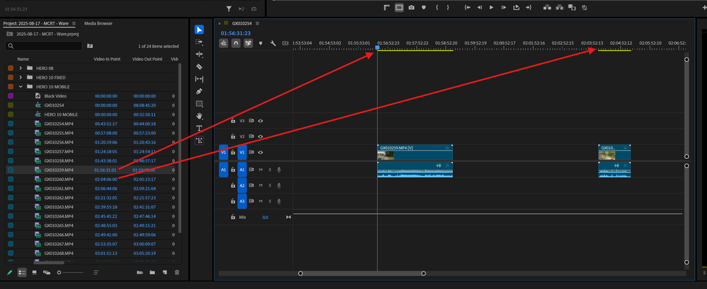

Right now I am selecting the Video In for EACH clip, copy, going to the timeline, double clicking on the playhead numbers, paste, and the playhead moves to that spot, drag the clip over. I am looking at doing this a few hundred more times today, so looking to see if there is a way to move them to line up with that Video In metadata, or better, some kind of shortcut key to click on the clip, "magic keystroke or script" and the video gets placed on the timeline at that spot without me having to go find it.

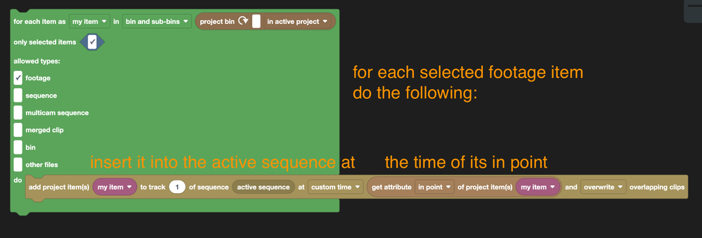

I just created this little script and added it to the Community Library of Automation Blocks:
Sequence/Populate/Insert Selected Clips Into Active Sequence at Their In Point.xml
Does this Automation Blocks tool do what you need?
To use it:
Just save the attached  xml file and load it into Automation Blocks for Pr (you can test it with the free trial).
The select all clips you want to insert and run the tool. It will insert them into the active sequence.
