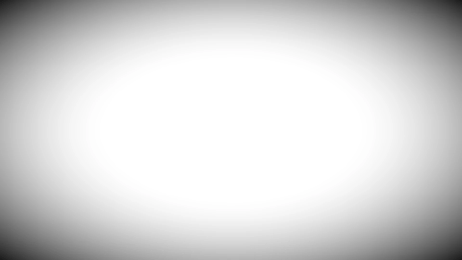

I've always created a vignette using the circle effect on a transparent video layer, inverting it and applying a feather.  The result can be made fairly subtle if you choose, and the vignette I use the most looks like this (applied over white video so it can be seen easily):

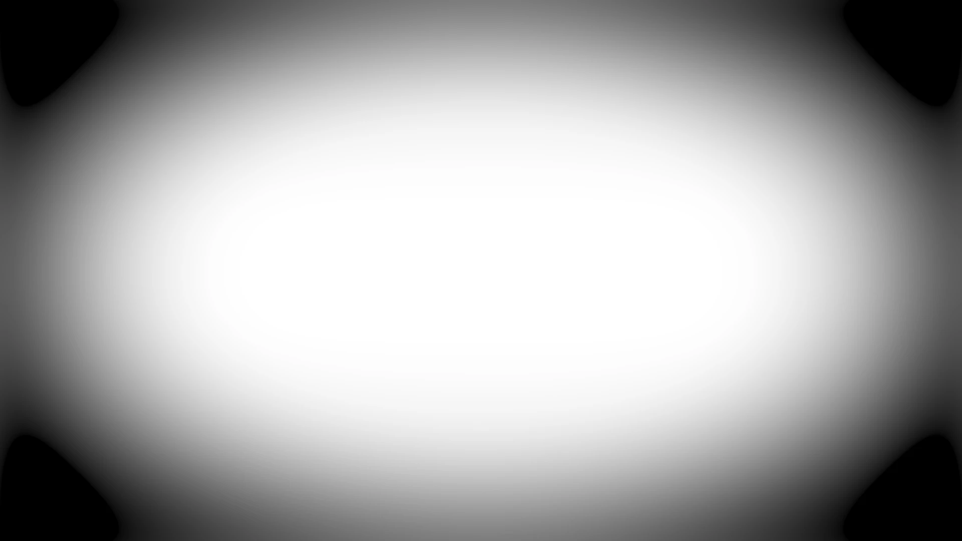

The problem is, I cannot find a set of parameters that create a vignette with this new method that approaches the look I am after.  This appears to be mainly because the mask feather is applied to the entire frame and not just to the circle shape of the mask.  That means you end up with a vignette that looks something like this:
Notice the black blobs in each for the four corners.  Also notice that the feathering is being applied to the vignette from the outside of the frame as well as from the inside, i.e. the black blobs are feathered towards the edges of the frame as well as towards the inside.

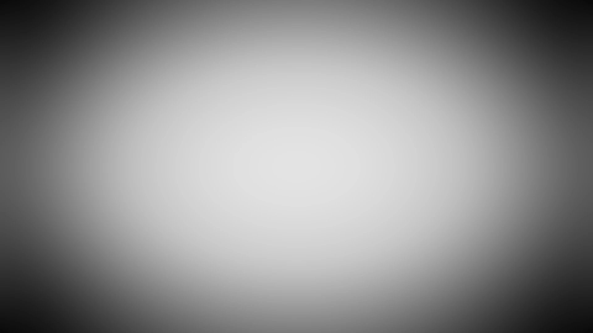

Of course, you can crank up the feathering to try to remove the blobs, but then the result is that the centre of the frame is now grey:
