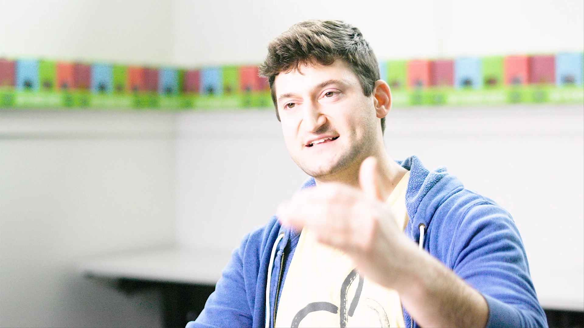

Export Issue - Maximum Render Quality/Depth
When I export to mp4 in h.264 or .mov in various flavors of Apple Pro Res I can no longer use the "Render to maximum quality" or "Render to maximum depth" check boxes. If I do the result is an export with a couple stops of added brightness. The attached images show the frame exported without those 2 buttons selected and with them selected. The one with blown out highlights is WITH them selected. Any ideas? This is way beyond the typical Premiere/Quicktime gamma shift.

The extreme shift in gamma values is pretty weird. Could be a combination of many things:
1. Lumetri correction on CC2019 is acting up on render
2. Your output format is different to the native codec of original files and is somehow affecting the gamma (although this would be very rare)
3. CC2019 has an issue when enabling the render max quality and depth settings
Are you rendering using software or hardware?
I personally feel if you are happy with the final output without enabling max quality and depth unticked it should be fine.
If you for some reason need a little higher quality bump up the Target and Maximum Bitrate sliders but please note these have considerable impact on the file size.
So lets do a process of elimination on a small sequence as a test.
1. Render and enable Render at Max Depth and leave Max Quality unticked.
2. Render and enable Render at Max Quality and leave Max Depth unticked.
The gamma shift will be appear one of the 2.
Trust this helps a little, Let me know.

ericas90264024
Nov 6, 2018 10:06 PM UTC
Ok now we're on to something. The gamma shift DID appear when "max depth" was checked but not on "max quality." I had done this test previously to posting here but not with VBR 2 pass. Only CBR or VBR 1 pass. I saw the gamma shift on both attempts.
Would the fact that both tests you just had me try were using "software encoding" and not hardware?
