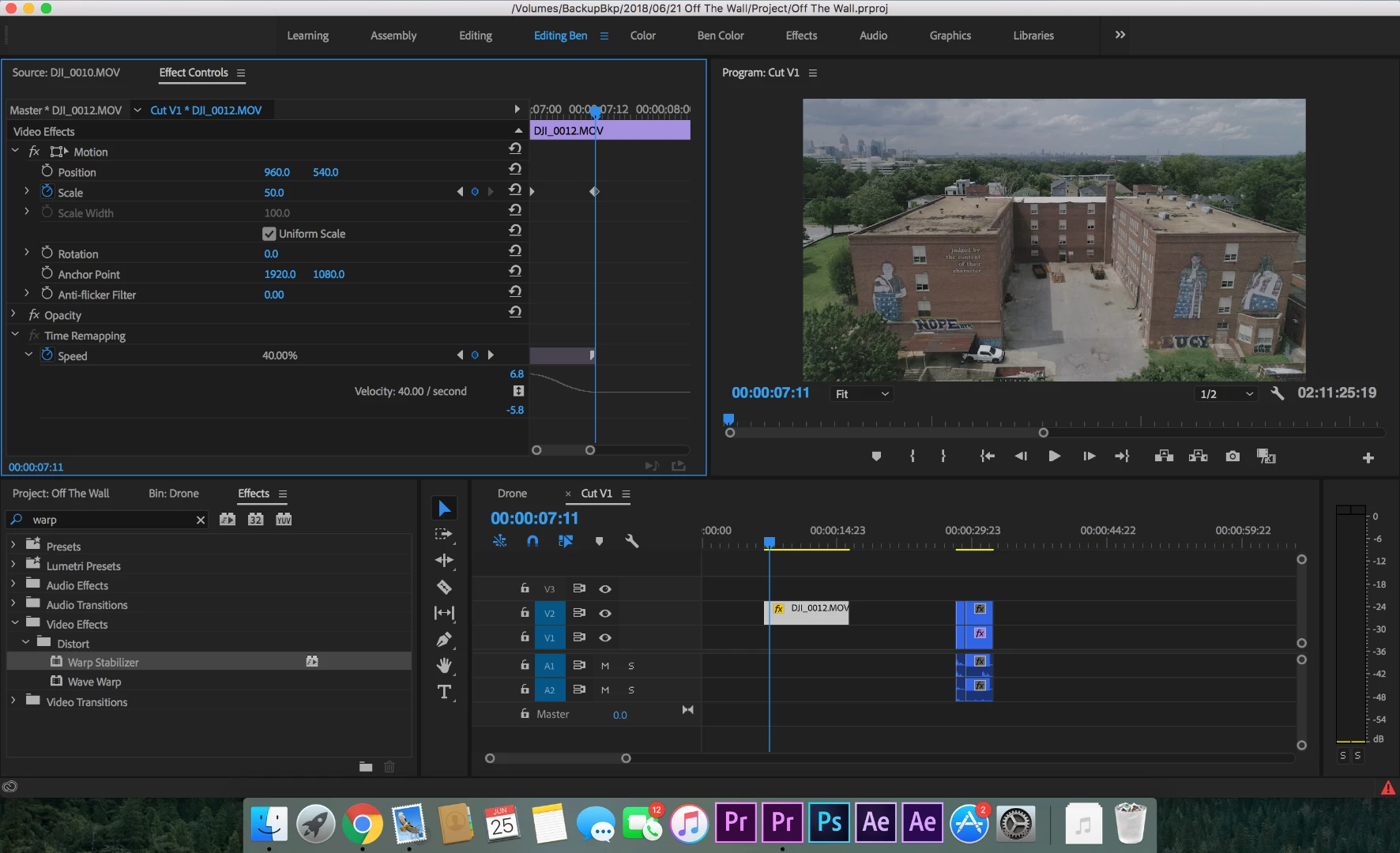

My out point/end of animation:
This is what it should like - 50% ie a full frame, so far so good.

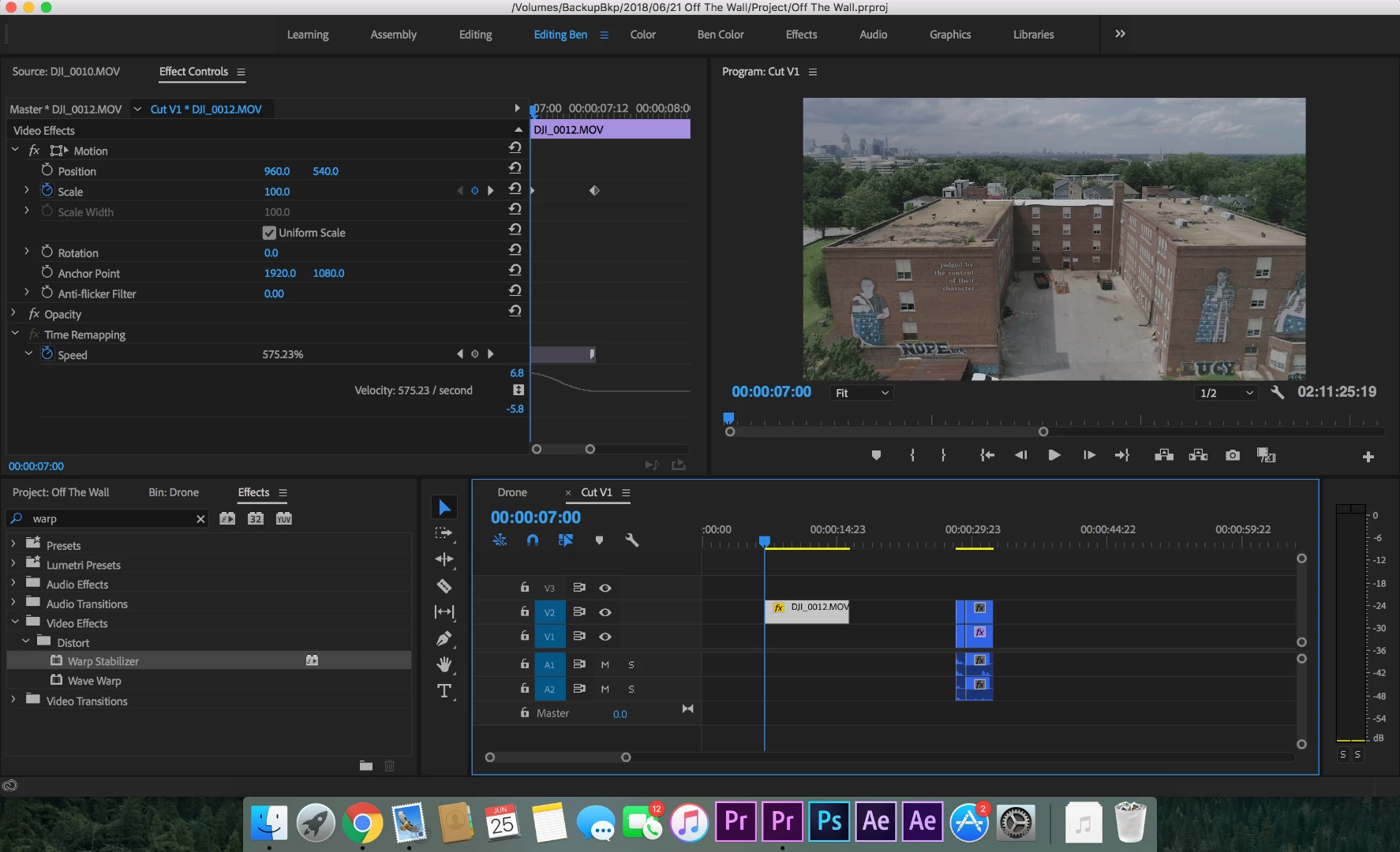

Here's my in point/beg of animation - Premiere glitching out:
Notice it is supposed to be at 100%, ie way more cropped in, but it's not doing it. This has happened several times now and is getting really annoying.
For clarity, because I know you don't know what the frame is supposed to look like, I will scale this to 500%, so you can see that there is no change:

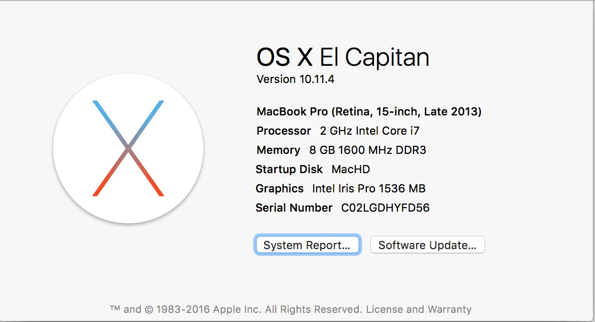

My specs:
Premiere CC 2018  - Version 12.1.0
