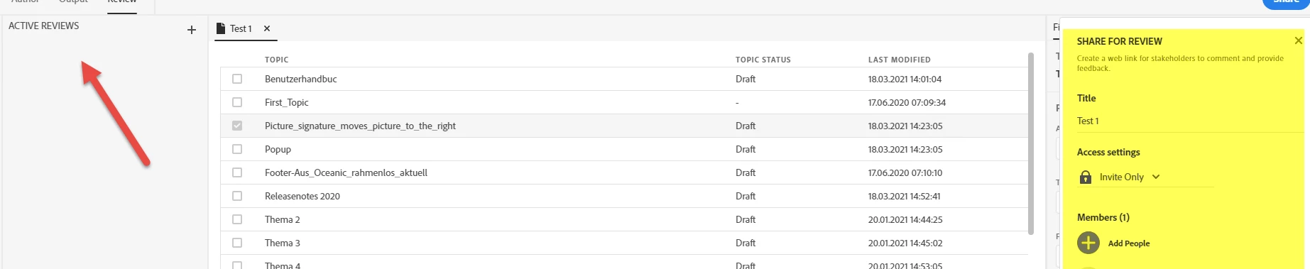

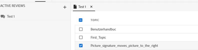

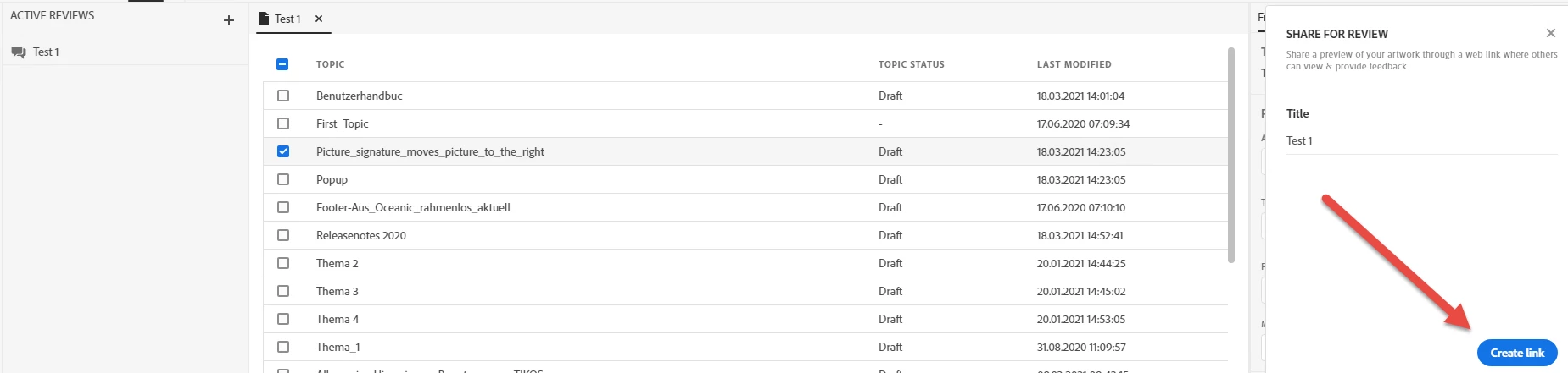

Hello Adobe-Community,
We are currently in the testing phase with Robohelp 2020 and are testing out the possibility of reviews.
We create a new group for active reviews and then select the content to be assigned to this group.
After that, we then share this review group. As soon as I have invited two employees, I no longer see the group in the overview.
Does anyone have a similar problem with this?

    In looking at this I never saw the right panel show in yellow. Is that something you have done for the screenshot or the way it appears in RoboHelp?
