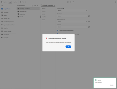

I am using RH 2022.2.22 (although I still don't get any response when I do About/check for updates). I am on Windows 11 installed on 4/4/2023.
I am able to set up a publish profile and the window says I am logged in. I get a message in the lower right-hand corner but then I get an error in the middle of the screen.
Then I go to create the output and I get the same conflicting error messages (see screenshot).
In the lower right "User Validated" but then in the middle the error message.
I am able to use all the information from the publish profile and log in manually, I have been made an administrator in our sandbox.
This screenshot shows that I am successfully logged in.
Any ideas on how I can get connected?

Explorer ,
Jan 12, 2024 Jan 12, 2024
I was given the wrong connection string by our sales team. Everything was fine after that was resolved. Someone from Adobe RH helped me figure it out. They were very helpful!
