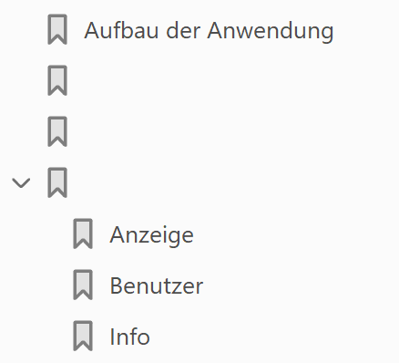

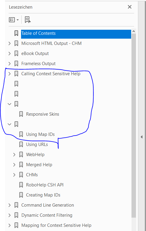

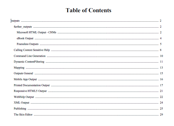

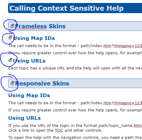

I just checked into these issues again with update 9 and a fresh sample project that I adjusted slightly. This is what I found:
1. the bookmark code is still wrong (saying <h1><a id="bookmarkname"></a>First Topic</h1>)
2. Folder names are still not shown in the PDF bookmark section
2.a) they are shown correctly in the PDF's TOC
3. Headers with bookmarks are partially displayed, but usually on a wrong level in the PDF bookmark section. So, something seems to have changed in the behavior here, but it is still wrong.
Example:
Topic structure
H1 without bookmark
H2 with bookmark
H3 with bookmark
H2 with bookmark
Display in bookmark section of PDF (- means one level down)
H1 without bookmark
- H2 with bookmark
Empty (H3 with bookmark)
Empty (???)
- H2 with bookmark
Empty (???)
- H3 without bookmark
4. JC2's issue also still exists. The header levels are only considered correctly, if they are all within the same topic. Across multiple topics, the header level is ignored in PDF both in the TOC and the bookmark section.
I created some screenshots of how it is displayed:
Image 1
RH TOC StructureRH TOC Structure
Image 2
PDF TOCPDF TOC
Image 3
PDF Bookmark SectionPDF Bookmark Section
RH Topic with bookmarksRH Topic with bookmarks

If I create the same bookmarks as in Image 4, I see the same gaps as you in Image 3. Did you keep a copy of the old thread and am I right in thinking that Adobe acknowledged the bookmark issue where you are saying the code is still wrong?
Please clarify what you mean by Item 2 in your last post. I am not getting what you expect to see or where.

Thank you! Issue 2 refers to the folder names that can be seen in images 1 and 2 ("outputs" and "further outputs"). These are not displayed in the bookmark section of the PDF, but should be. Folders are used as structuring elements either directly in the project or just in the TOC of the project, so they should also be shown as such in the bookmark section, shouldn't they?
The other thing besides the code being wrong that does not work is the consideration of header levels in the bookmark section (the issue that JC2 reported initially. Header levels are only considered within the same topic. If you are having a topic with header 2, it is displayed on the same level as the "parent" topic with header 1.
I hope I could clarify my post.

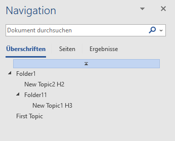

First, the result in Word (PDF-output fails, so I created Word documents) always is the same, with the checkbox Maintain HTML heading levels ticked and cleared (with respect to what I am talking about). However, in classic the result is as I would expect it. I created some screenshots that hopefully show what I mean:
Image 1 (Project Manager in RH):
Project ManagerProject Manager
Image 2 (TOC in RH):
TOC in RHTOC in RH
Image 3 (Navigation bar in Word / expected bookmark section in PDF):
Navigation Bar in Word (should look the same as Bookmarks in PDF)Navigation Bar in Word (should look the same as Bookmarks in PDF)
The checkbox Maintain HTML heading levels takes effect, if I put the "First Topic" with H1 header into Folder 1. With checkbox cleared, it will become a H2 in the output, with checkbox ticked, it will remain H1. But this is not what is causing me problems.
I hope I could clarify everything. If not, please continue asking me. I am trying to explain the best I can 😉
