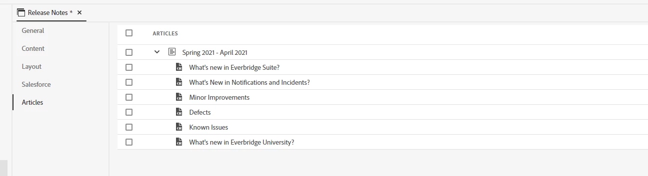

I have configured everything successfully and I am just in the process of creating my output preset. And I click on Articles tab and I have this screen. So my question is, will each if the topics be a separate article? It looks like the answer is yes. So if I want all my topics to be one kb article I need to have one RH Topic?

    Hi Joannah,
    Yes, each topic becomes one KB article, so you will need to have one RH topic to publish one KB article.

    Thank you Stefan, that answers my question. We are using Salesforce Classic Knowledge so I won't be able to do this. That's a shame!
