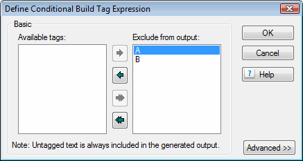

I have one file that produces two versions of help. Lets call them A and B. In RH7, I used conditional tags to mark topics and text as either part of A, B or both. I then created a conditional build expression for each that included only topics with A or B, respectively, or both A and B. I've been told that you are supposed to exclude items in conditional build expressions, but for me that didn't work in RH7.
In RH8, I discovered that in order for the conditional build expressions to work, I have to use the exclusion option. This means that I have had to go through all of the topics that included both A and B tags and remove them. This isn't so bad, really. The tough part was the conditional text within the topics. I have several topics that have both conditional text for A and B. When generated, the topic showed both. To solve this issue, I had to open each topic, make one small change (like putting in a space and then deleting it) and save the topic. After regenerating the two versions of the files, the conditional text appeared correctly.

Glad you have got it working but I think it could have been easier. If you had reversed the CBT names by renaming them and then amended your build expressions to NOT whatever, I think that would have done it for you.

So, if I had built the expressions to say "NOT A" when I wanted B, and "NOT B" when I wanted A?
Or do you mean if I'd written them to say "A Not B"? I did try that, but it didn't seem to work. At this point I'm not sure if that was because I hadn't opened and saved each topic that included conditional text, or if the expression itself.

You just cover what you do NOT want.
So if you had A, B, C and untagged you would use
NOT A
NOT B
NOT C
NOT A and NOT B
and so on.
