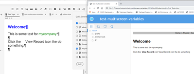

Here's a side by side, where I did a blue heading colour and large p tag font for the editor stylesheet to showcase the difference vs the output generated.
You can try it out on just a topic or two, to make sure it works for you.
