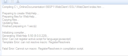

Now, RH stops responding when the compile starts. The stop is very early in the process.
I can compile CHM files.
In Output View, I see the following message:
Initializing complier
Generating Webhelp 5.50 (9.0.0.228)…
Error: Can not register active script for language javascript
Template Error: can not resolve macro: RegisterResolvers
Fata Error: Cannot run macro: Register Resolvers in compilation.

April 15, 2013
Please re-register jscript.dll
  1. Right click Command Prompt and select Run as Administrator.
  2. Navigate to:
                [Windows\System32]   for 32-bit OS or
                [Windows\SysWOW64] for 64-bit OS
3. Type "regsvr32 jscript.dll."
Hope this will solve your problem.
moszapy1,
First, my thanks to everyone who has helped with the issue.
I also had some help from Vikas and Mohd. at Adobe after posting a bug report. My thanks to them for responding also.
I did try using RH on my home computer as noted earlier. The problem did not exist there.
The fix provided by moszapy1 solved the problem. The same fix was provided by Adobe also.
Thanks again to everyone for helping.
