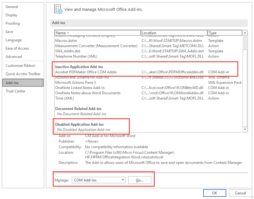

Regarding the "Failed to generate printed documentation" when generating a pdf, I've been getting that constantly in my testing because something keeps disabling the PDFMaker plugin in Word. (It should remain enabled, but I'm waiting for a new computer before getting IT to troubleshoot it. I'm currently leaning towards the antivirus...)
I also hope i'm not barking up the wrong tree - I can't find any documentation about PDFMaker related to Robohelp, but I can't generate to pdf when this add-in is disabled. I do have Acrobat DC (not Reader) and Distiller.
To check the PDFMaker is enabled by doing the following:
  1. Open Word.
  2. Select File > Options.
  3. Click the Add-ins section in the left panel of the dialog box.
  4. If Acrobat PDFMaker is listed in the Inactive Application Add-ins:
    • In the Manage list, select COM Add-Ins, click Go, and select the checkbox next to Acrobat PDFMaker Office COM Addin. OK out of the dialog boxes.
  5. If Acrobat PDFMaker is listed in the Disabled Application Add-ins:
    • In the Manage list, select Disabled Items, click Go, click on Acrobat PDFMaker and click Enable. OK out of the dialog boxes.
  6. Try generating the PDF again
Lija.NAuthor
March 2, 2020
The Acrobat PDF maker is already enabled and the PDF is still not generating.
Anyway, i generated the Word copy, formatted it and generated PDF from it.
Thank you for your help.
Lija

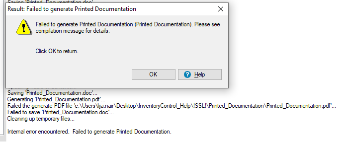

2) I tried to generate PDF using PDF Output and Printed documentation. But i am getting error in the end. Could you please let me know how to print properly formatted PDF and Word using Robohelp.

What error are you getting when trying to generate in Robohelp?
Lija.NAuthor
February 27, 2020
Hi
I am getting "failed to generate printed documentation"
