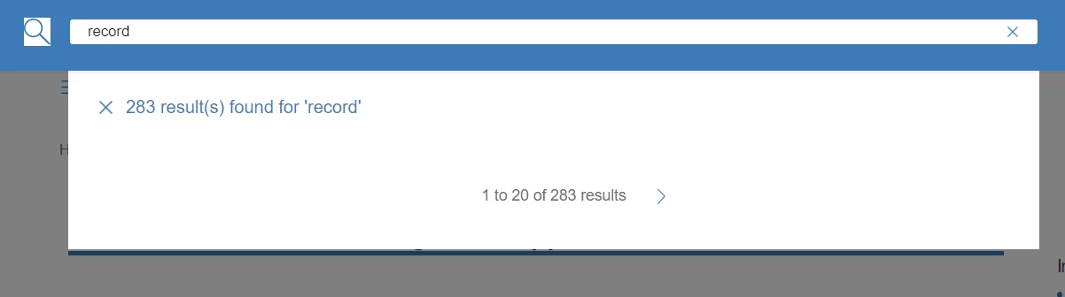

Search results don't display from the output (frameless), even though it says there are results. It does work directly from View Output in RoboHelp, but it's not working in our test environments. I think this post is similar: https://community.adobe.com/t5/robohelp-discussions/search-stopped-working/m-p/13852327. Is there a fix? Thank you!

    How are you putting the output on to the test server? Are you using Publish and if so, which option? File Transfer, FTP etc.
    Repeat putting the output on the server the same way you did before. If that doesn't help try zipping it and unzipping.

    @Dana26548320ehdw Try this.
    On the server delete the whxdata folder. Then publish your project again. It has fixed the issue for me.
    Why it went wrong is another matter but hopefully that will fix it.

    Thank you for the response! We use SFTP. We also select "Republish All" so I think that whxdata folder should be deleted automatically anyway?
    It seems to be fixed now, thankfully! I'm not sure exactly what fixed it. Here's what we did:
    1. I deleted my local project and redownloaded it.
    2. I delete the generated files folder.
    3. I re-generated.
    4. For unrelated reasons, I wasn't able to republish the same way we did before. We zipped the files instead.
    Thank you for the help!
