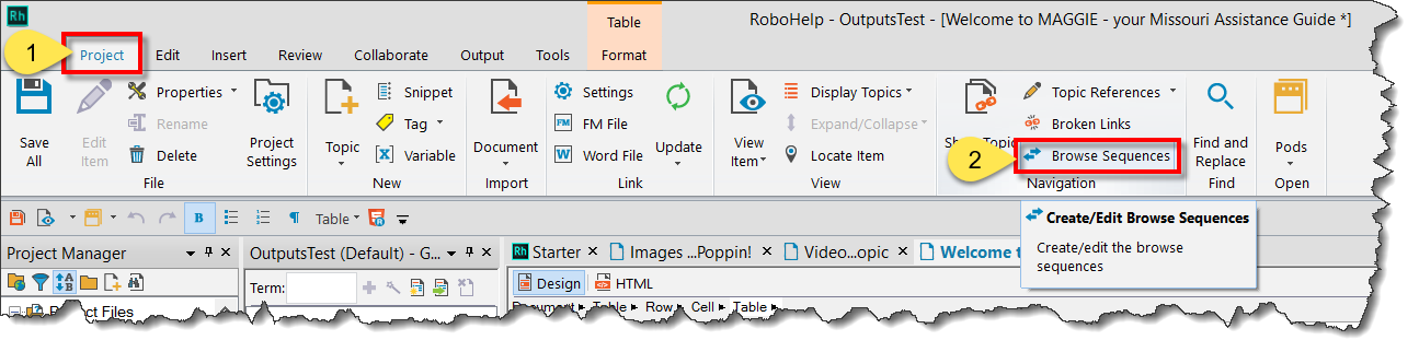

Normally the Back and Forward buttons are linked to a Browse Sequence. I'm guessing you haven't defined a sequence yet.
Try clicking the Project tab and Browse Sequences.
Cheers... Rick
Cheers... Rick

Thank you, Rick. That was indeed the problem. In our WebHelp_Pro layout we were able to display back and forward buttons that were based on the last topic you visited, not browse sequences, so that was where I was looking. Thanks for the prompt reply:-)
