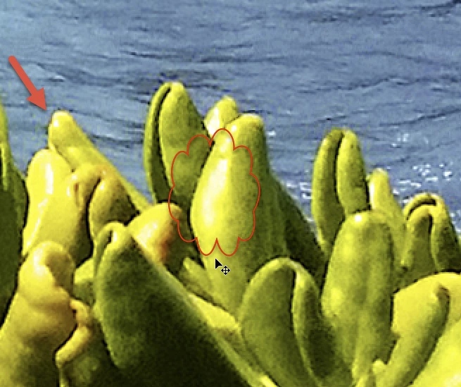

This extract of your first image seen at 200% shows that your processing (in camera processing?) destroyed image detail, probably because it was considered noise.

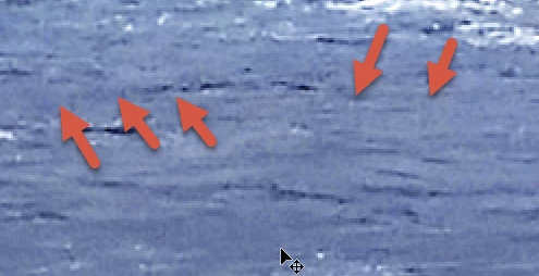

On your second image (also examined at 200%), I see chromatic aberration (arrow), blown out highlights (cloud) and generally noise.
The crests of the waves are blown out and show no structure, the rest of the water is washed out, the water splashes on the rock are unusually geometrically confined.
The software has inserted geometric patterns in places.

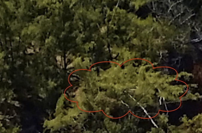

The first one also has issues along the treeline with fringing (probably from trying to deepen the blue colour of the sky and the autoselect also grabbed the tips of the trees.)  The sky itself seems noisy.
