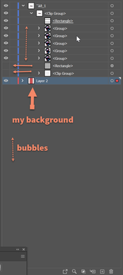

April 20, 2021
Transparency with such illustrator files works only against colour backgrounds.
You see my red rectangle works fine with the bubbles. To the left and the right of the rectangle I have an empty background (shown in white, but there is no background fill so what you see is the default visual of a 100% transparent artboard. I have switched off the visibility of the chequerboard and a grey background from the original visual. Here is the layers' palette:

AbamboCommunity ExpertCorrect answer
April 21, 2021
I do not know what you are intending with your file, but all transparency effects that I've seen so far work only against a background. That background may be someting complex like a drawing or a photo, but the effect cannot exist by itself.
