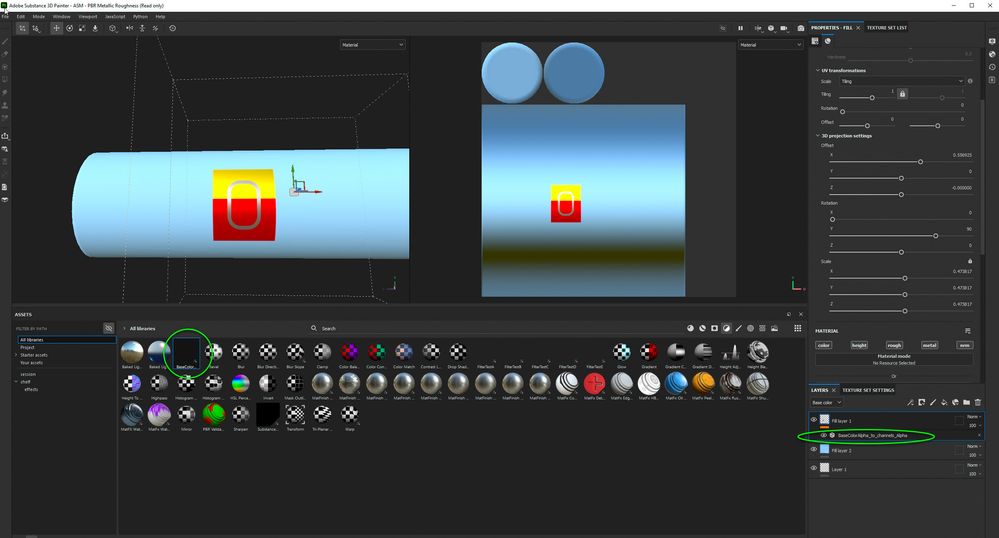

Sep 16, 2022 Sep 16, 2022
Hi
I found a way to restrict the other channels to the non transparent areas of the basecolor using a custom filter.
Make a channel specific filter in Substance Designer and connect the channels as shown. The Alpha split node extracts the transparency from baseColor.   Note for the metallic, roughness, and height channels I duplicated the outputs and changed the name, the usage and identifier of those duplicates to metallic_Alpha, roughness_Alpha and height_Alpha.
Save the sbs file and publish it to your Painter effects library as an sbsar.
Next open up painter and add a filter to your material layer. Drag and drop this new filter and teh channels will now be restricted to the non transparent areas of the basecolor.
Before filter:
After Filter:
I've attached the sbsar, which you can drop into your shelf library, and the sbs that you can adapt and edit.
