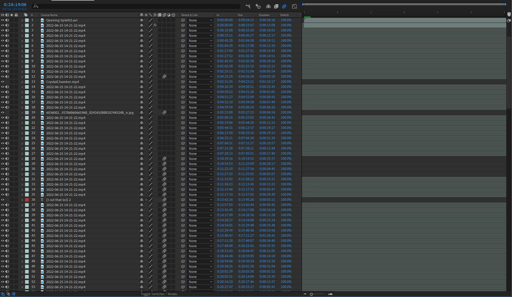

The first issue the error is causing is that it, in essense, wipes my timeline. Whilst all of the layers are still present, all but two of the visible ones are 'empty' - and only the top two can be manipulated; the other half being below the maximum depth my timeline now goes, meaning I can't interact with them.
You can see from the above screenshot the 'empty' layers, and the top two being the only ones I can manipulate. There are at least another 50 or so layers below the bottom one, that like I mentioned, are essentially cut off from the rest of the timeline.

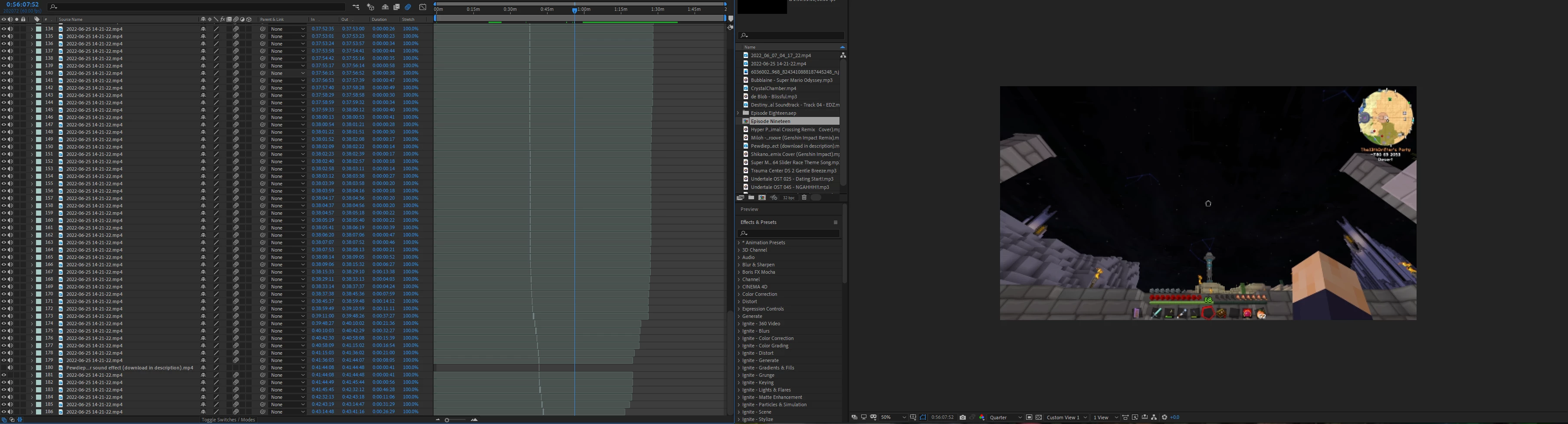

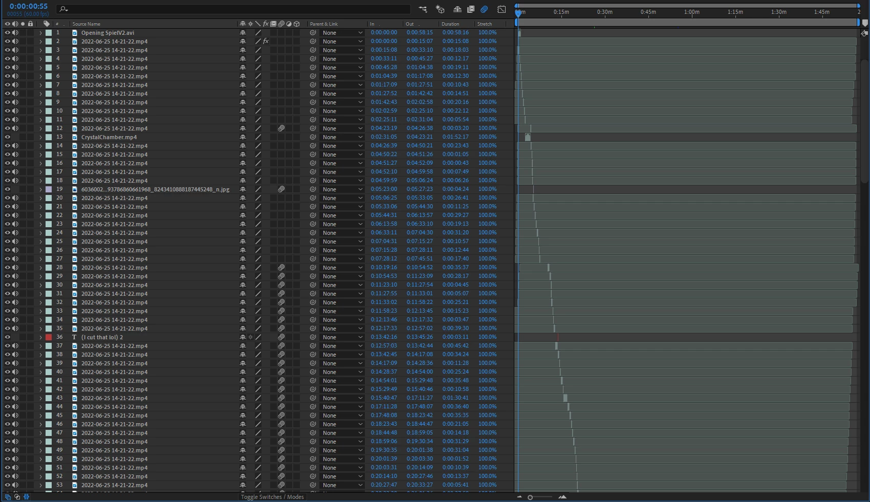

Pressing the spacebar (play), I can 'restore' the 'empty' layers- and see how they were originally cut together. I can even still watch my edit, however I still can not access the rest of the layers that are below the cut off point. Screenshots below.
As you can see from the above screenshots, like I mentioned, my edits are restored- however the rest of my edits are still there, below the cut off of my timeline.

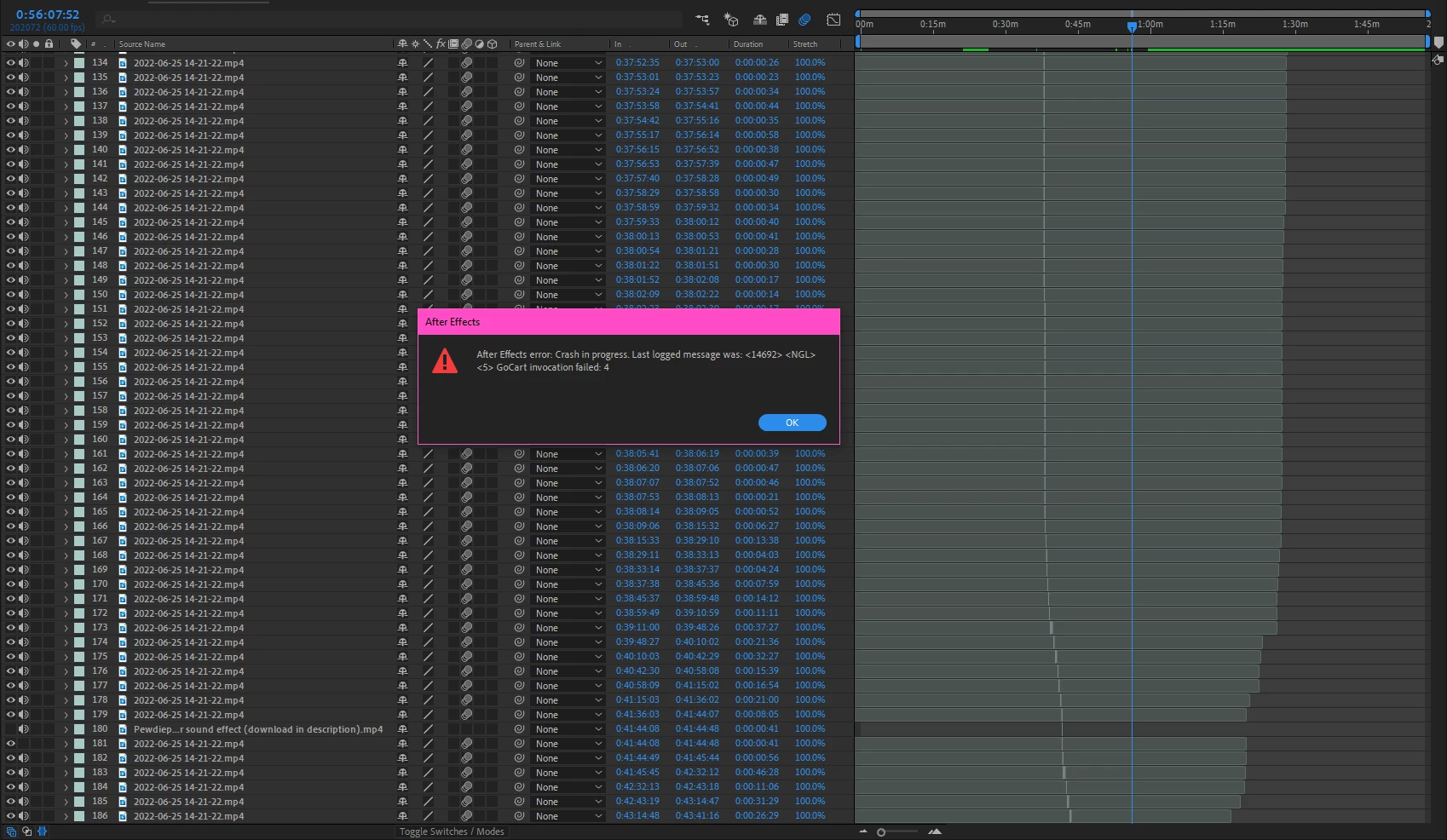

That's right; the final issue this error is causing is that upon pressing 'M', the whole studio crashes. See the enclosed screenshot.
