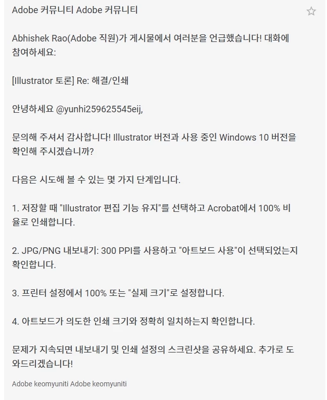

이게 답변입니다
해석을 해보니,,,
이런말인데.............

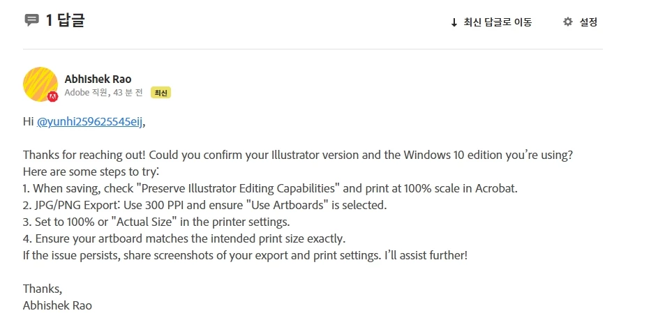

Hi @yunhi259625545eij,
Thanks for reaching out! Could you confirm your Illustrator version and the Windows 10 edition you’re using?
Here are some steps to try:
1. When saving, check "Preserve Illustrator Editing Capabilities" and print at 100% scale in Acrobat.
2. JPG/PNG Export: Use 300 PPI and ensure "Use Artboards" is selected.
3. Set to 100% or "Actual Size" in the printer settings.
4. Ensure your artboard matches the intended print size exactly.
If the issue persists, share screenshots of your export and print settings. I’ll assist further!
