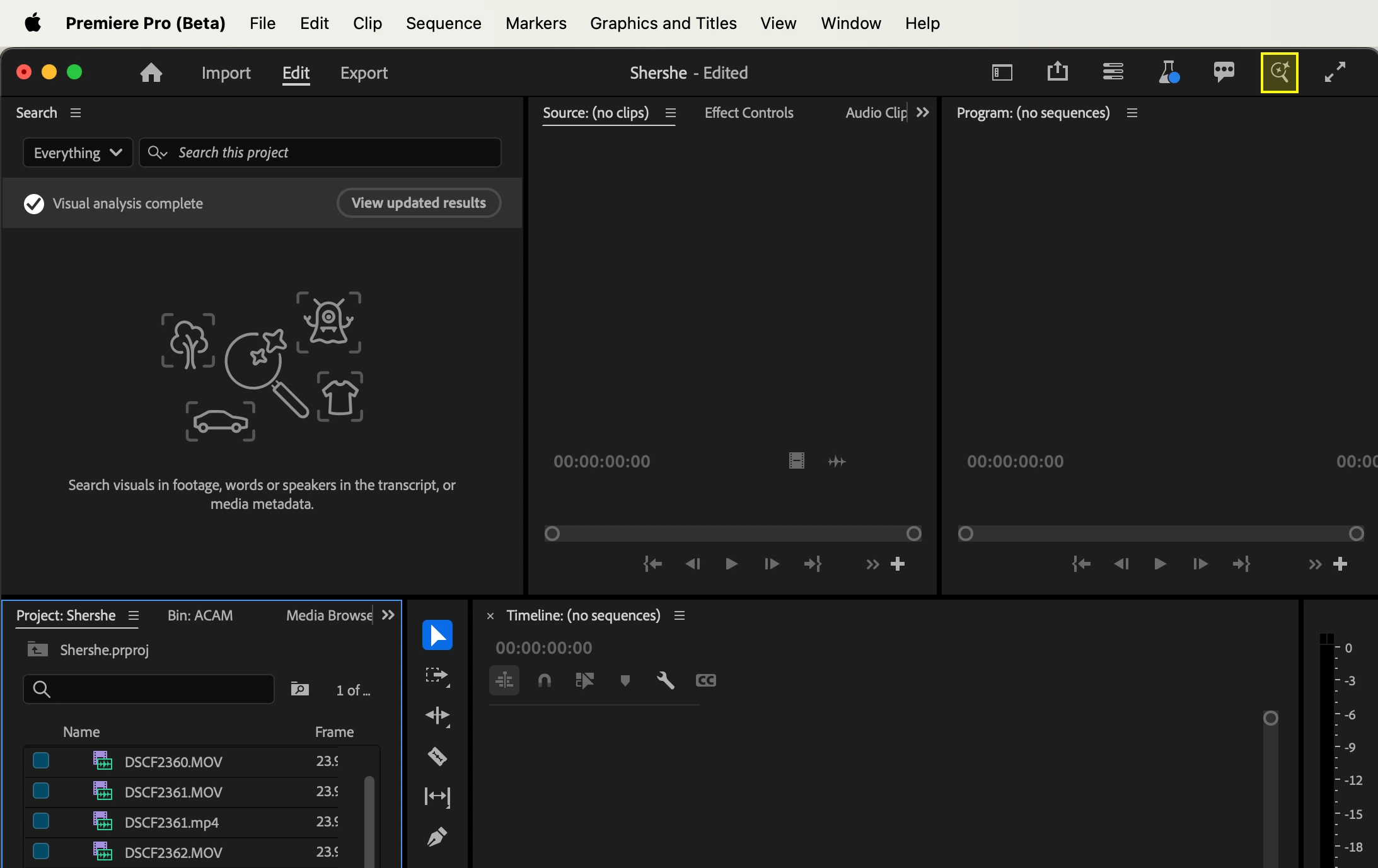

  2. Open the Search panel by clicking the magnifying glass button in the upper right corner of Premiere Pro app or under Window > Search.

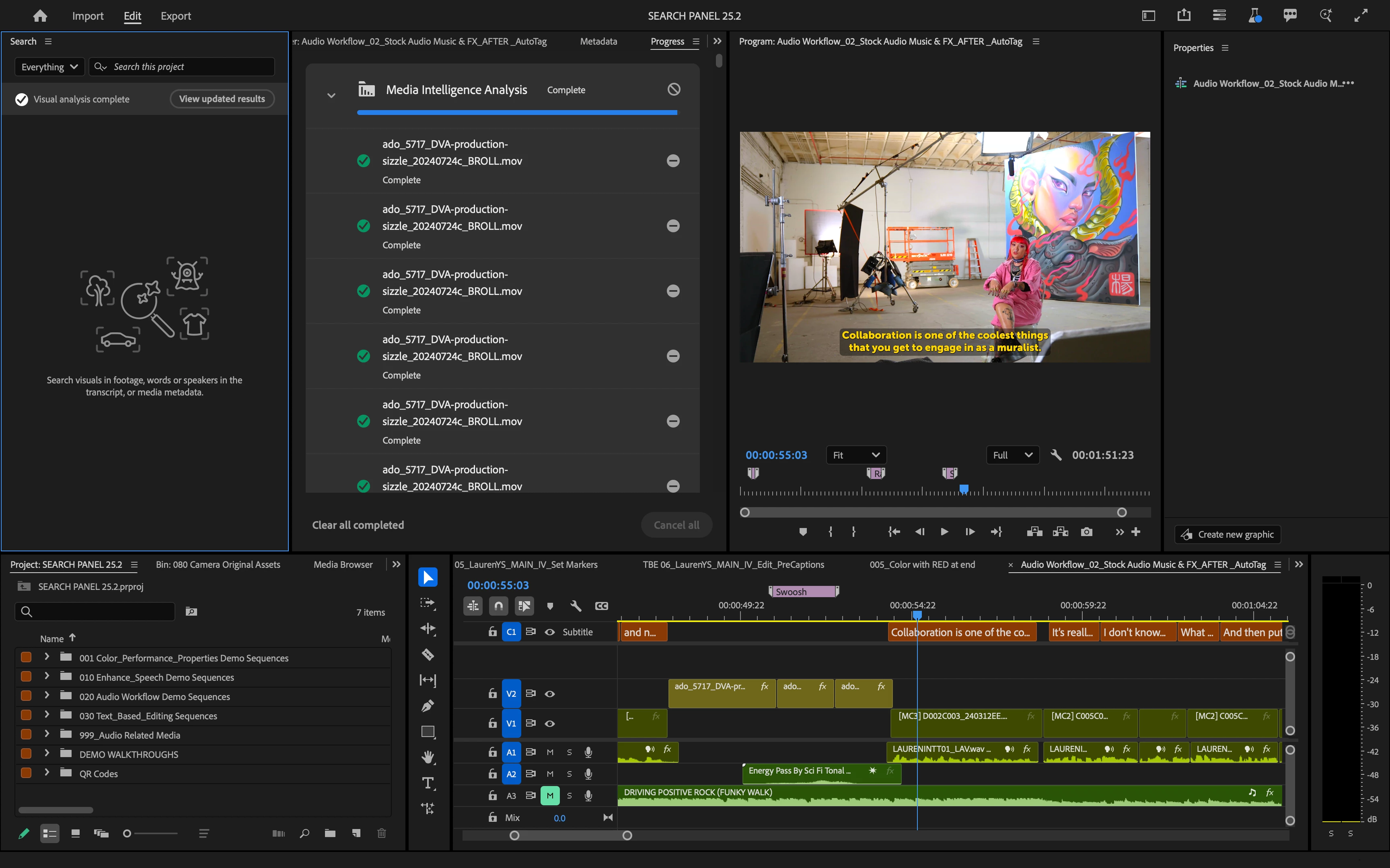

  3. Let the background analysis process finish. When the analysis is finished you should see ‘Visual analysis complete’ in the Search panel.
  4. Type in the search field. Visual search can give better results the more specific you are in describing the scene.

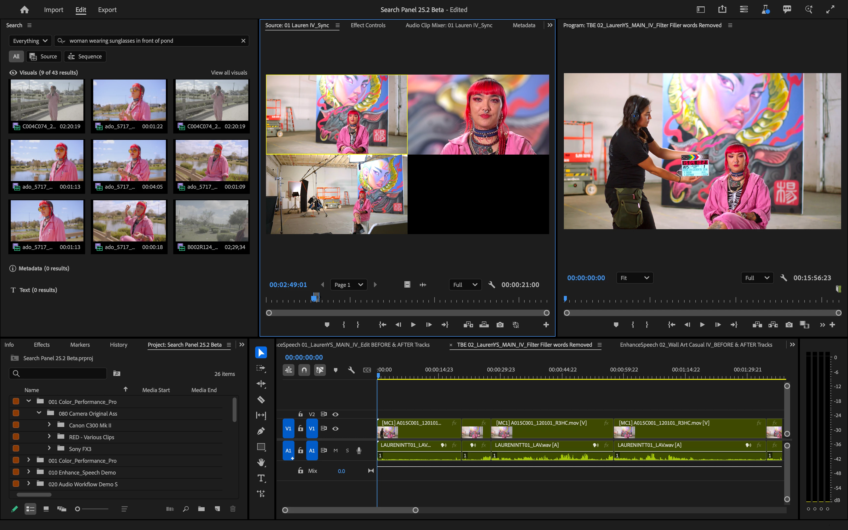

I have something good to report on this search: I've got a bunch of clips of birds, (my own stuff, not for a client), so it's not documented as well as it could be... :-), But I put in my first search, 'many birds sitting on a wrought Iron fence' and wow, it found the exact clips I was looking for, and very quickly.
So, thank you very much, this is a cool new feature! 🙂

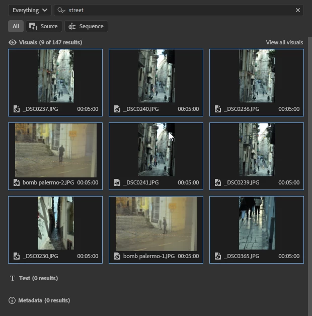

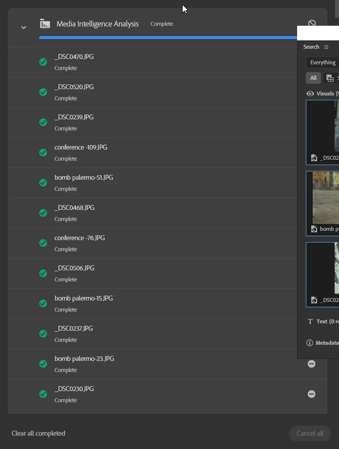

I made a first attempt, imported photos instead of videos, so as not to overload the system. The engine read everything and indeed then I could search for people or a street and create a sequence from them on the timeline.
