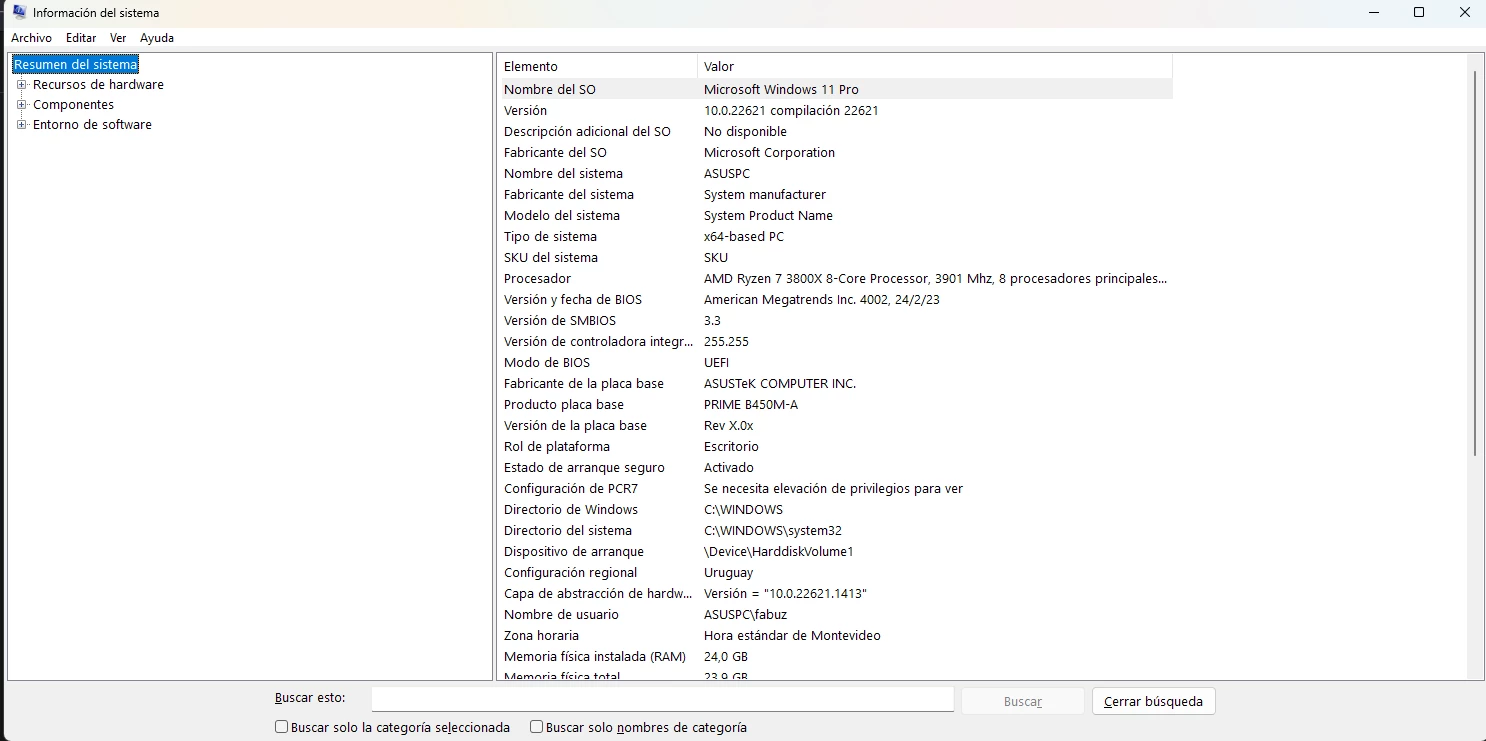

I've tried deleting old configs, reinstall GPU driver but it seems like the beta version works totally fine.
PC specs attached as I can't upload the crash dump file
