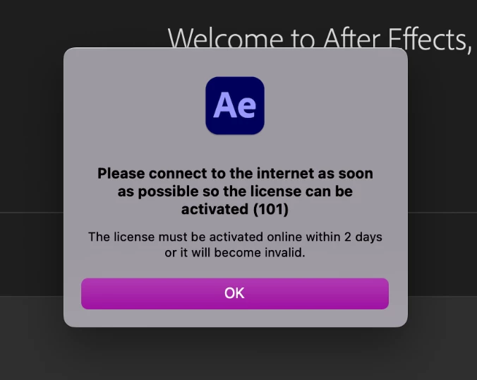

When I open After Effects, I get this message:
“Please connect to the internet as soon as possible so the license can be activated (101). The license must be activated online within 2 days or it will become invalid.”
This has been happening since yesterday. I’ve already reinstalled the app, signed out and back into my Adobe account, but the message keeps appearing no matter what. I’m really worried because I have important projects to work on in the next few days, and it would be a huge problem if After Effects suddenly stopped working even though my license is valid.
I’ve followed all the troubleshooting steps mentioned in another thread, but nothing seems to fix it. I’m getting desperate. Thanks in advance.
