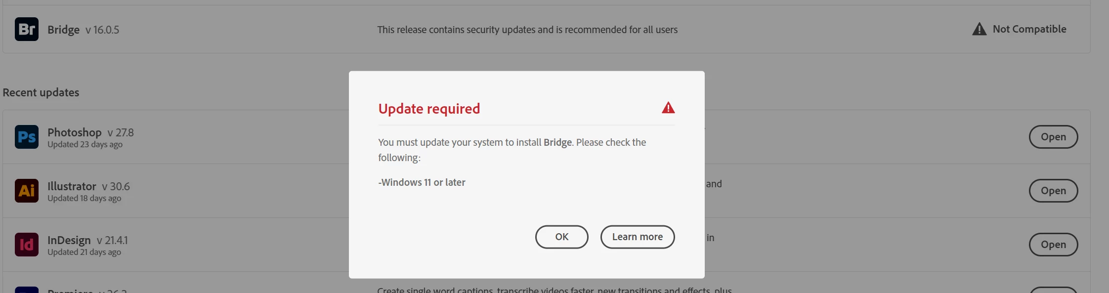

    I find it truly shameful and disrespectful toward paying customers that you have decided to drop support for Windows 10.
    We are talking about Adobe Bridge, a file management application—not a piece of software designed to generate complex 3D renders or perform large-scale AI processing.
    And above all, we are talking about Windows 10, the second most recent version of Windows, which is still widely used because not everyone can afford or justify constantly upgrading their hardware.
    We are not talking about prehistoric software like Windows 98.
    To make matters worse, your documentation is inconsistent. Some of your official support pages in languages other than English still state that Windows 10 is supported by the latest version of Bridge, while Creative Cloud refuses to install it and requires Windows 11 instead.
    You cannot even keep your own support documentation consistent and up to date.
    Adobe, you should be ashamed of the way you are treating your paying customers.

    Bridge 16.0.5 has been released and is compatible with Windows 11 and later.
    If you are using Windows 10 and currently have Bridge 16.0.4 installed, please uninstall it and reinstall Bridge 16.0.3, as version 16.0.5 is not supported on Windows 10.

    Hi, could you please explain, how can I reach v16.0.3 ?
    I cannot see other than the latest one v16.0.5
