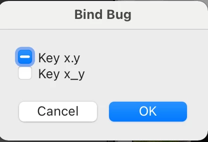

P: SDK: LrView.bind (key) fails when "key" contains a period
LrView.bind (key) creates a non-working binding when "key" contains a period. To reproduce, install this plugin:
https://www.dropbox.com/s/fhx9521z9re47ro/bind-bug.lrdevplugin.2022.01.16.zip?dl=0
and then do File > Plug-in Extras > Bind Bug. That will produce this window:
The first checkbox should be unchecked (white), not in the mixed state (hyphen).  Tested on LR 11.1 / Mac OS 11.6.2.
Just one more SDK bug to work around.
Here's the script for the Bind Bug command:
local LrBinding = import "LrBinding"
local LrDialogs = import "LrDialogs"
local LrFunctionContext = import "LrFunctionContext"
local LrView = import "LrView"
local bind = LrView.bind
local f = LrView.osFactory()
local key1 = "x.y"
local key2 = "x_y"
LrFunctionContext.callWithContext ("main", function (context)
    local prop = LrBinding.makePropertyTable (context)
    prop [key1], prop [key2] = false, false
    assert (prop [key1] == false)
    assert (prop [key2] == false)
    LrDialogs.presentModalDialog {title = "Bind Bug",
        contents = f:column {bind_to_object = prop,
            f:checkbox {title = "Key " .. key1, value = bind (key1)},
            f:checkbox {title = "Key " .. key2, value = bind (key2)}}}
    end)

June 18, 2022
This was only partially fixed. The behavior is "as designed", but it was (and still is) undocumented in the API Reference for LrView.bind().
The Lightroom Classic Programmers Guide has been updated on page 98 with this sentence:
"The keys in the table are treated as “.” (dot/period) separated hierarchical key-value pairs, e.g. a key such as x.y would bind with the key y in the table bound to key x."
The API Reference documentation for LrView.bind() should be similarly updated:
"key (string) A key name for the observed property. If the key is of the form x.y, it references to the key y in the table bound to key x."
Here's a modified bind-bug.lua for the plugin above that illustrates the behavior:

    end)
