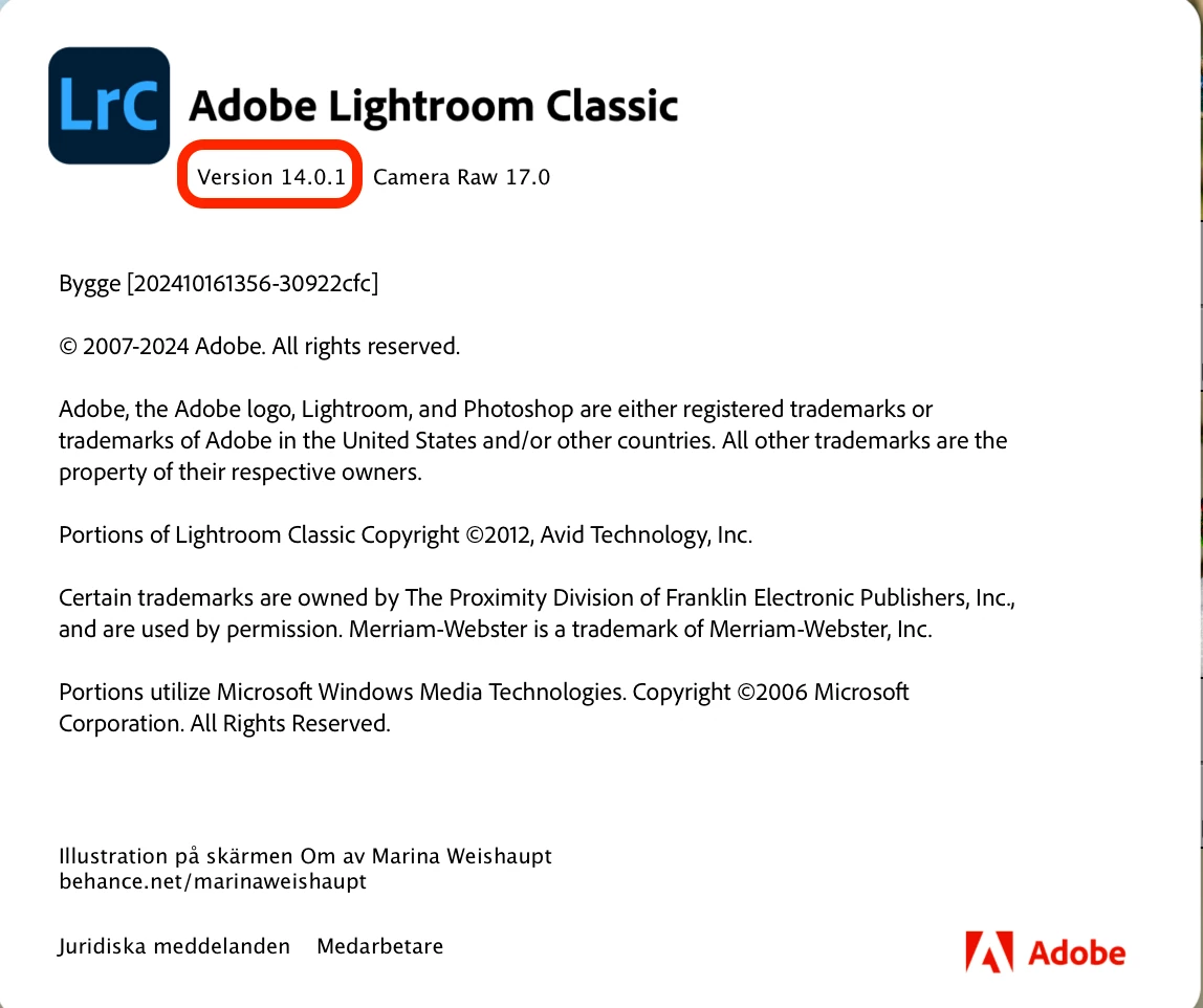

October 16, 2024
What are you saying ? There is a LrC version 14.
Even a 14.01 from today
