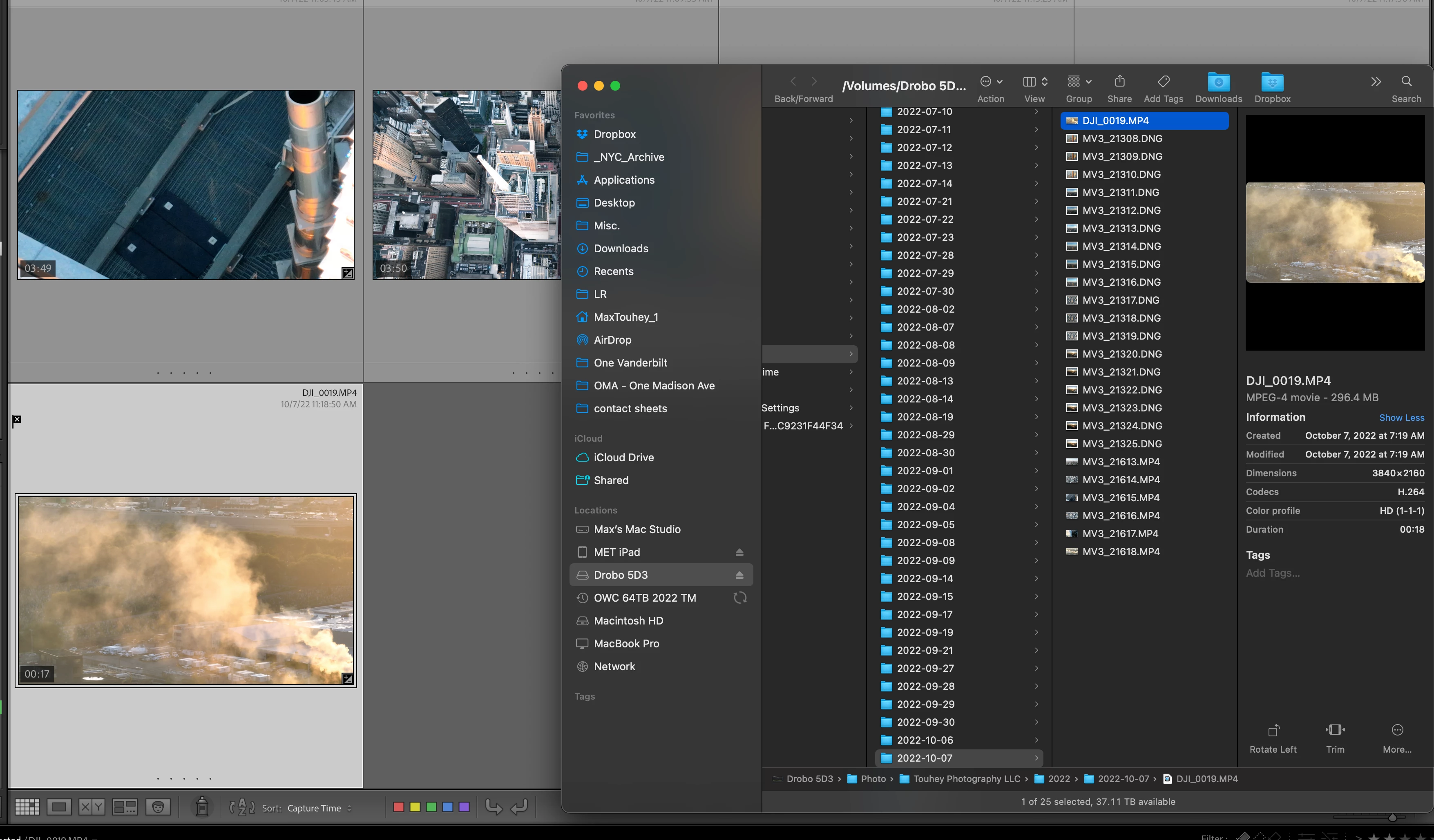

The short: video assets are approx 4 hrs offset from actual time in LR Classic. Issue persists with multiple cameras and on multiple computers. Issue does not affect photos, only video.
The long: I noticed in the last few months that video files have been ending up at the tail end of each days collection when they should be mixed in with the photos. Then I noticed the timestamps were wrong -- about 4 or so hours off. Not exactly 4 hrs but wondering if the length of the clip may account for that since they're about 3 or 4 minutes off from being exactly 4 hrs with 3 or 4 minute length clips. About 4 hrs 1 minute off for 30 second clips, etc.
I noticed this issue persists with multiple cameras, including my iphone and in LR Classic on my Mac Studio and MBP.
See attached images for LR timestamp vs. the correct timestamp shown in Finder.
Any help would be greatly appreciated since this is leading to other issues!
