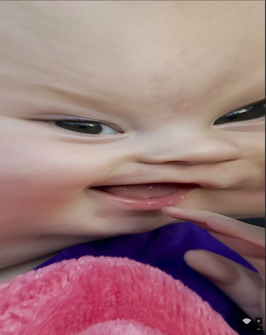

 I am having a problem with photos being distorted after syncing to LR cloud but only viewed at full screen.  The thumbnail are OK.  All images that are distorted were modified in Photoshop and saved as either a PSD or TIF.  However not all psd's or tif's are distorted.  Most of them are.  The distortion is severe.  Raw files and jpg are fine.  There is no distortion once I upload them to Adobe Portfolio.  It also has a strange symbol on the bottom Right corner.  None of my photos that are not distorted have these symbol.  All these photos have a custom crop.  I am using LR Classic ver 10.2   See picture.

 I am having a similar problems with photos synced to LR cloud but only viewed at full screen.  The thumbnail are OK.  All images that are distorted were modified in Photoshop and saved as either a PSD or TIF.  However not all psd's or tif's are distorted.  Most of them are.  The distortion is severe.  Raw files and jpg are fine.  There is no distortion once I upload them to Adobe Portfolio.  It also has a strange symbol on the bottom Right corner.  None of my photos that are not distorted have these symbol.  All these photos have a custom crop.  I am using LR Classic ver 10.2   See picture.
