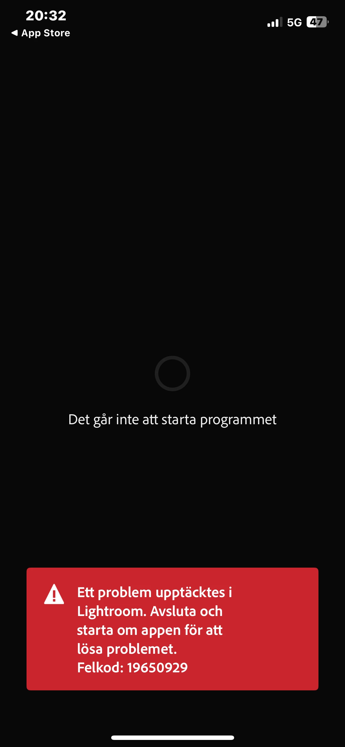

I cant open my Lightroom-app on my iPhone. Code 19650929 appears.
i have uppdated my phone and i have the latest uppdate of the app. I have restarted my phone and the app several times but it does not work. I have a paid subscription.
What do I do? I work mostly from my phone.
