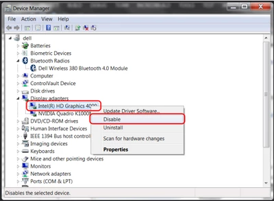

Is your system up-to-date? Do you have installed all recent updates and patches for the operating system and the device drivers, especially the graphic driver. Please make also sure that you have installed the Studio version and not the Game Ready version of your NVidia driver.
Check in the Windows Device Manager if there is a Intel UHD GPU aktic. If yes, please try to deactivate this GPU in device manager in Windows and activate the GPU support in the PS preferences. Then check.

Zkusil jsem podle vašeho odkazu vypnout použít grafický procesor a zatím to pomáha a obrazovka nečerná. Přes to by mě zajímalo, pokud to s tímto nastavením bude v pořádku, proč se to děje. Díky
