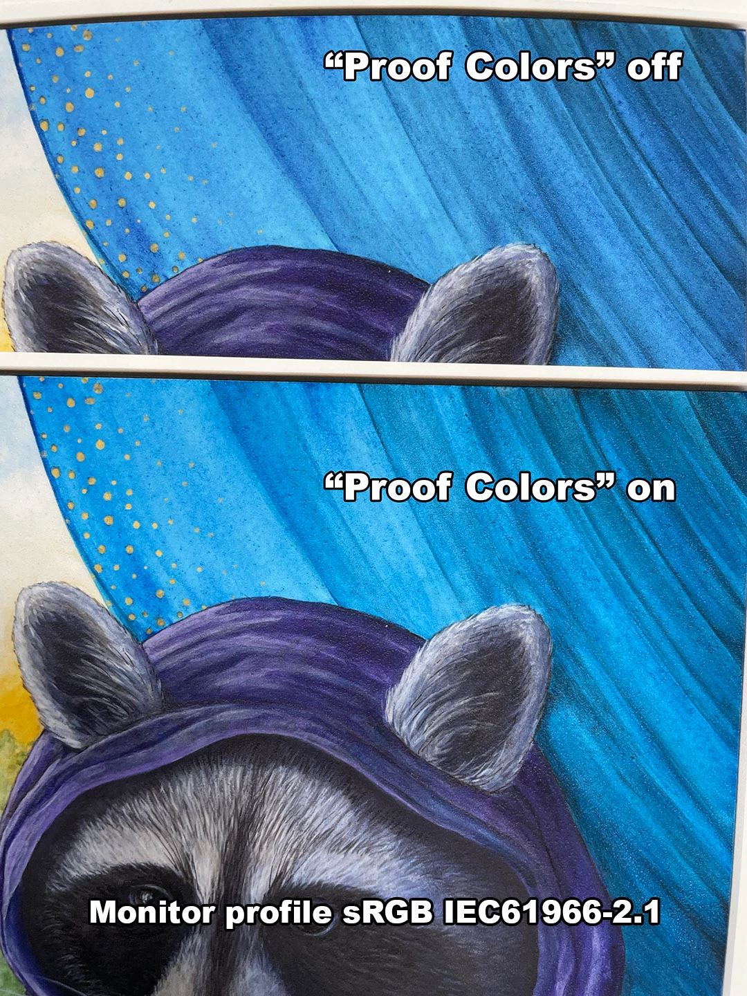

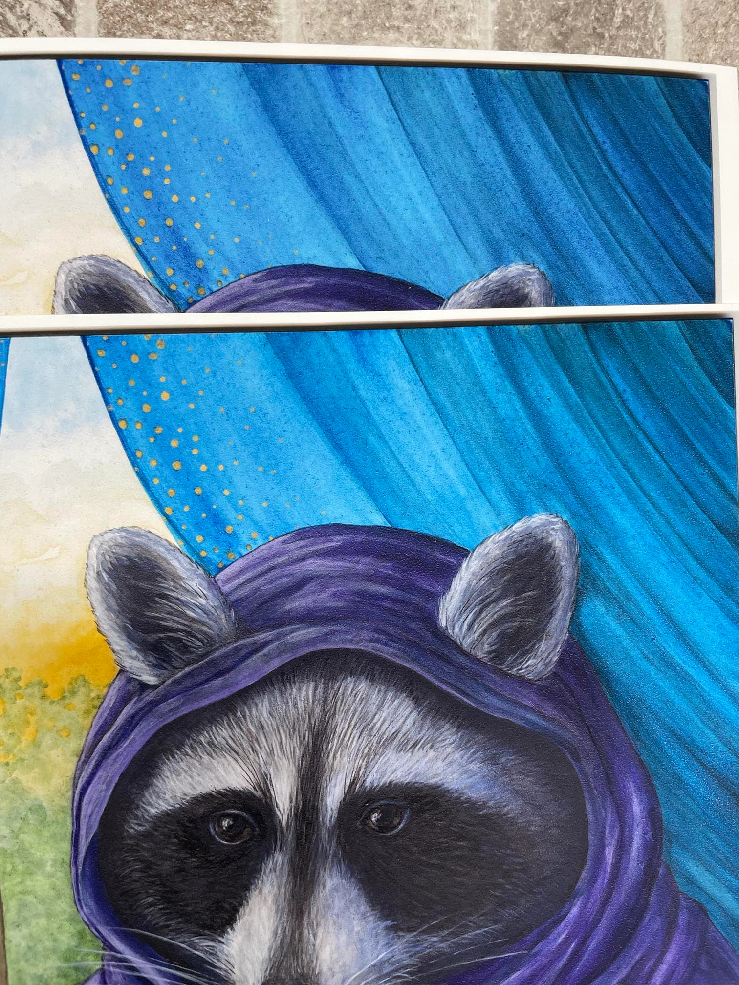

Changing the setting "View>proof colors" is changing the color of my printed pieces.
Hi All,
I am running the latest version of PhotoShop (26.0.0) on a Mac running OS 14.7, and printing to my Canon ImageProGraf 4000.
I have noticed that when toggling the "View_Proof Colors" on and off it changes the way my prints look!
I have always understood that this setting would never effect my actual prints, it is supposed to only effect the on screen color and simulate the intended output result.
Has anyone expierenced this behavior?
I will try to attch an image showing the difference. The top image is a print with the view proof setting on, and in the bottom print it is off.
It will be hard to see the difference in the image but if you look closely you can see that the bottom image has less magenta in the deeper blues, and the cyan is more vibrant.
Can anyone help me figure out why this may be happening?

Blumer8
Blumer8Author
Nov 6, 2024 1:28 PM UTC
Thank you for your help, I can't tell you how much it is appreciated!
Like you had alluded to, this has caused me a ton of stress over the last couple years.
I've always been proud of the fact that I could absolutely nail the color of my clients art in my prints.
I have my monitor, scanner and printer all calibrated, and have created a color managed workflow that has made my process much faster and efficient.
Then this happened (whatever it was), and I had to go in to all my files and rework the color again, it was hours and hours of work, cussing and stress.
And even after all that, I still cannot produce the vibrant color that I was able to produce before, using the same paper, ICC profiles and printer!
I still find myself getting mad just typing this. Somehow something changed (probably in the macOS like you said), and now I am considering getting a windows laptop just to send files to print from, but that isn't a great solution.
Thanks again, you are the only person that I've spoken to about this problem who took the time to look onto it, and understood enough to suggest a solution.

I've changed the monitor profile to "sRGB IEC61966-2.1" as you suggested, and reprinted the test with "Proof Colors" on & off. The difference is still there.
Also, I noticed the color is different now compared to when I had the monitor profile set to the HP setting.
Once again, I didn't think that changing the monitor profile would effect any change in my prints!
