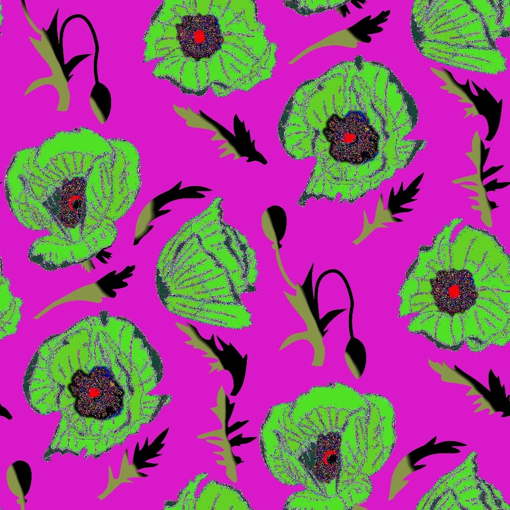

P: 23.2 Issue - Previously saved files with adjustment layers open with strange colors
After updating to Photoshop 23.2, if you have a file previously saved (example .psb) with adjustment layers like Curves or Channel Mixer, the image opens up with strange colors in the part of image where the adjustments impacts. To fix the issue, I need to go to adjustment layer, turn it off (via eye icon) and turn it back on.
Photoshop team, could you please fix this bug so I do not have to use above hack on my previously saved images with adjustmensts when I open them.

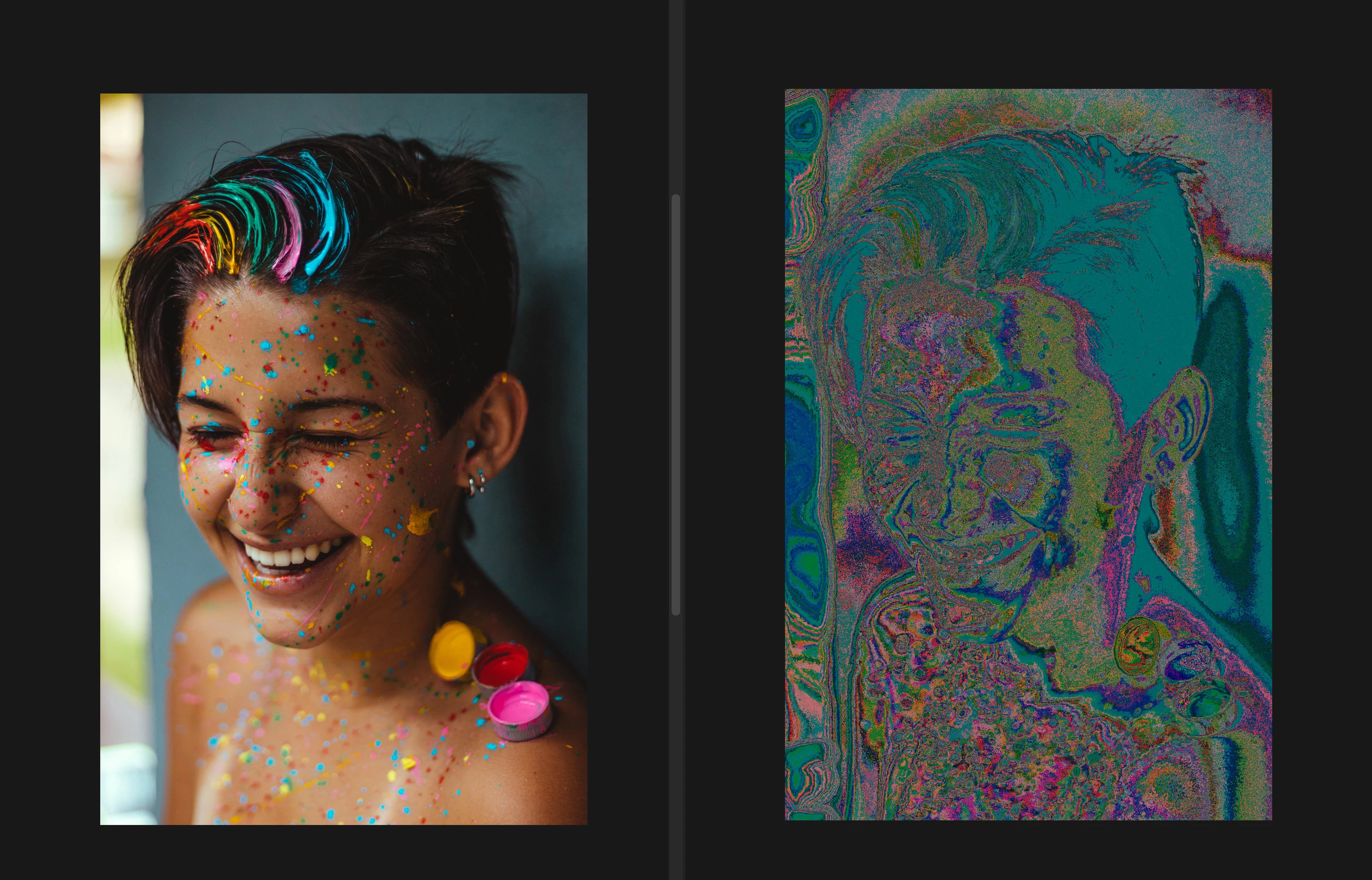

As of today, I made the 2022 (23.2.2) update from 2020 (21.2.3).
After update when i open any PSD file which saved from 2020 version its colors interestingly different.
This one in 2022
Same file in 2020
When i close the file and open again it changes the color again
The psd file has hue/saturation adjustment layers and when i adjust master hue +1 and then -1 it turns normal colors. But it is not a proper solution right? I've been using 2020 with no problem so my system is okay. is there any idea for this ridiculous problem? Thanks and sorry my english.

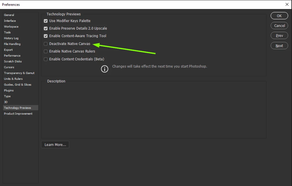

Hi
Try enabling this option in preferences and restarting Photoshop to see if it helps
If that doesn't help can you uploaded the PSD

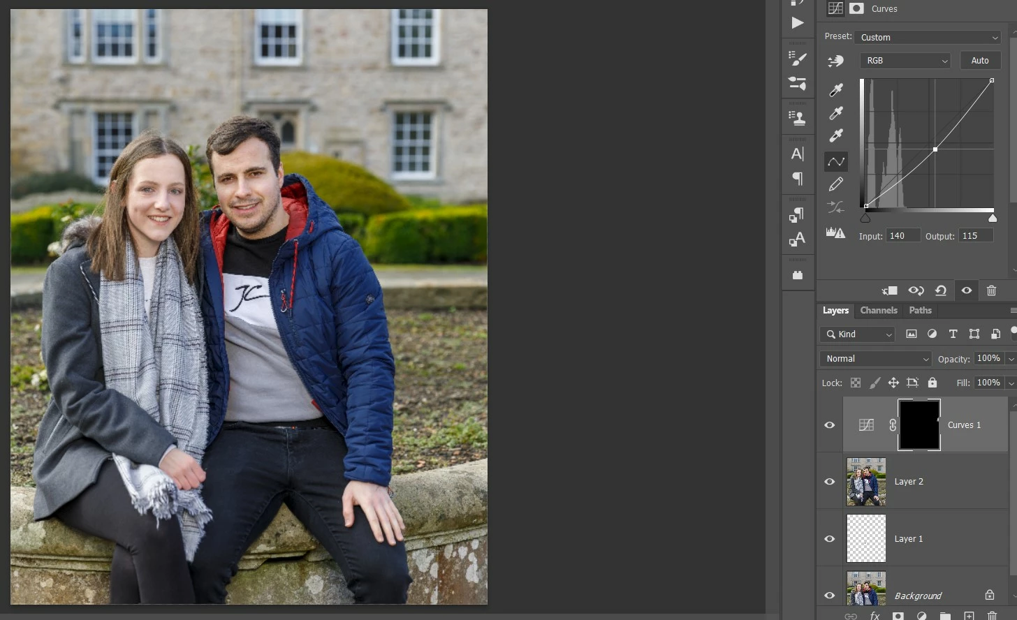

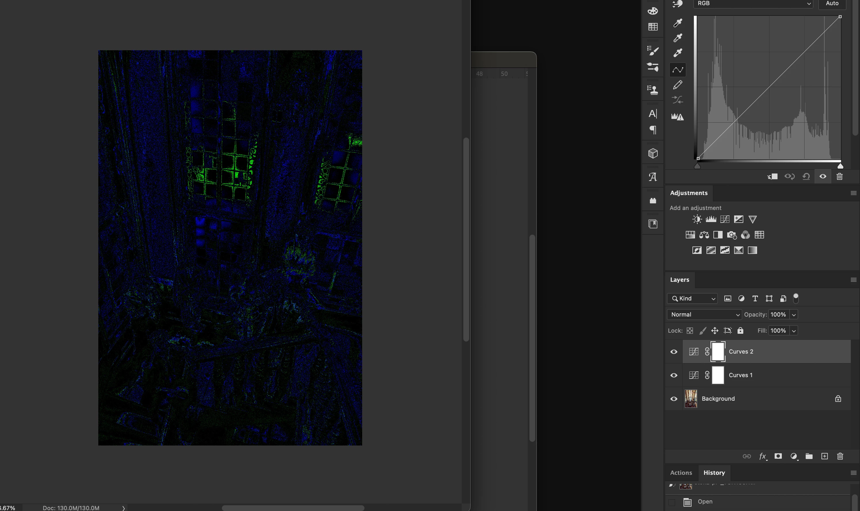

Mar 26, 2022 4:15 PM UTC
Firstly, my specs:
Macbook Pro M1 Pro running Montery 12.1
Photoshop version 23.2.2
As soon as I add an adjustment layer (most adjustment layers anyway) the image turns completely corrupt looking - see attached example, where I just added a single curve to the image.
Now, if at this point I interact with the adjustment layer in any way (i.e. adjust the curve) this effect dissapears, and it looks normal. However, if I then save the document and re-open, and of the visual corruption re-appears. As you can imagine, if I'm working on a file with many adjustments, it becomes a nightmare to go in and do tiny tweaks to all the adjustments everytime I work on the file, just to be able to see what i'm doing properly!
This first started to happen when I recently updated Photoshop to version 23.2.2, however now the problem persists even if I roll back multiple versions prior.
Things I have also tried so far to no avail:
Temporarily Disabling GPU
Clearing Cache
Deactivating Native Canvas
Opening images in different colour profiles and combinations of 8/16 bit
Running via Rosetta instead of Native Mac M1
But nothing so far has made a difference. It is making working in Photoshop basically impossible and i'm desperate to find a solution.

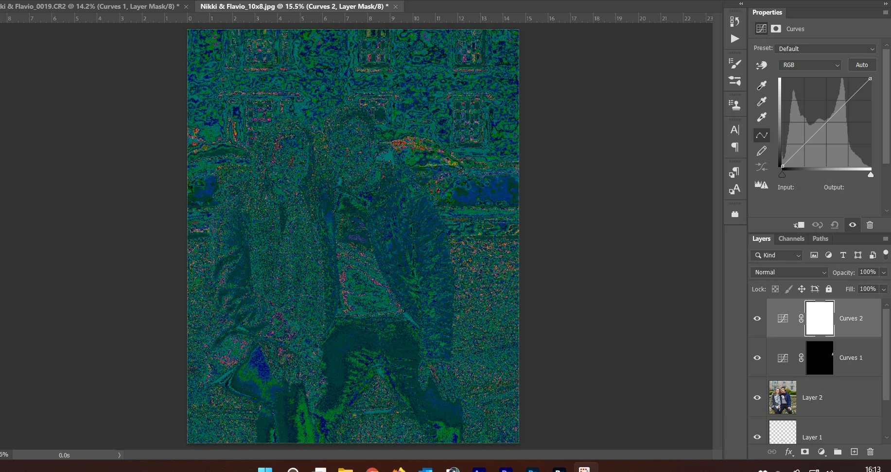

Mar 24, 2022 4:30 PM UTC
Hi photoshop community, if anywhere has the answer it's usually right here. I have a fairly hi spec PC running Windows 11 64 bit, i9 processor 64gb ram, Nvidea graphics. I am having an issue in that when I am editing in photoshop, if i load a try to an adjustment layer, i am getting a pretty funky inverted screen. In the attached image, when I add in a curves layer for instance, pre adding it is how it should appear, then wehn i add the layer it goes on inverted. as soon as i click on the curve it reverts to the normal look, it's pre the adjustment it's got that inverted layer look. It's happening with any adjustment layer
I've attached a couple of screen grabs, hopefully my post makes sense
photoshop error before and after

Hi
I can't replicate the issue on my system although I'm on Windows 10 with an Nvidia RTX2060 Super GPU, do you use the Nvidia Studio driver or the Game Ready one, Adobe recommends the Studio version.

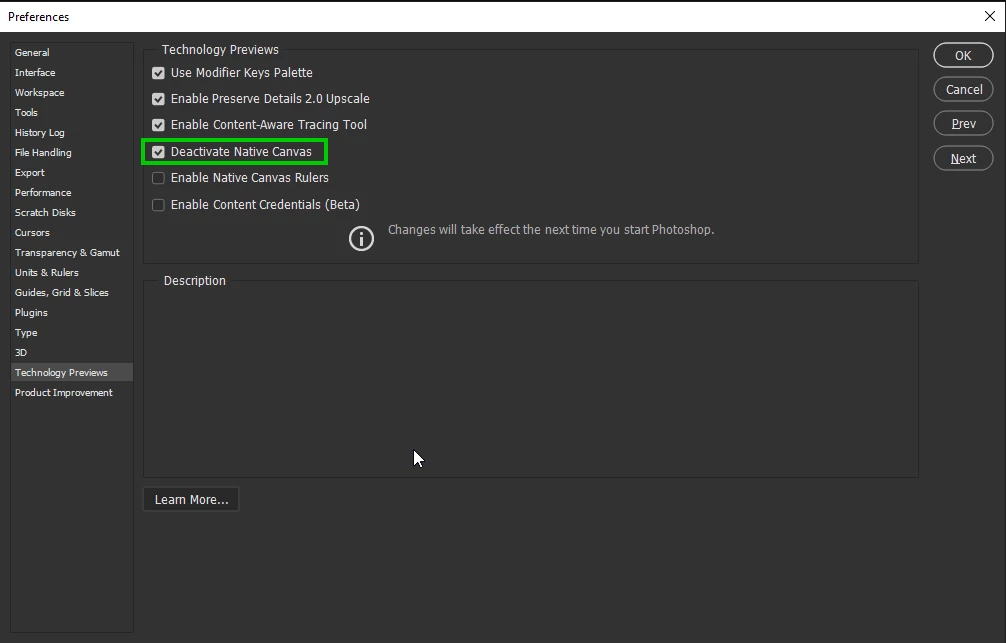

Go to Preferences > Performance... and uncheck Use Graphics Processor. Restart Photoshop. Does the problem persist?
Go to Preferences > Technology Previews... and check "Disable Native Canvas" - then restart Photoshop. Does the problem still occur?
If this doesn't help try to reset the preferences of Photoshop using the steps described here:
