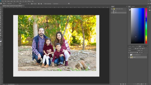

P: Content aware tool not working
I'm trying to extend an image and when using the crop tool with the content aware box checked, it does nothing. I just used this tool yesterday with no problems. I'm assuming an update bug broke it. Any ideas??
