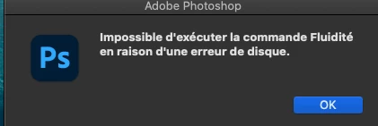

Bonjour,
quand je veux lancer le filtre fluidité, cela me marque: Impossible d'éxécuter la commande fluidité en raison d'une erreur de disque.
Que faire, merci

Hi @ChristophePhoto24 sorry to hear this.
Let's make sure we're in a default state and there are no stale settings somewhere:
Restore your preferences using this manual method:
https://helpx.adobe.com/photoshop/using/preferences.html#Manually 
Does it work correctly?
If that doesn't solve it, you can quit Photoshop and put the Settings folder back.
It may help if we could see your Photoshop System Info. Launch Photoshop, and select Help >System Info...and copy/paste the text in a reply.
Thank you,

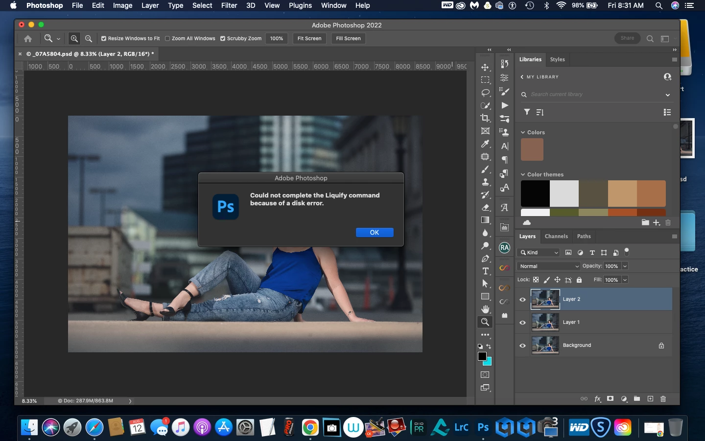

August 2, 2022
Hi!  When I try to use liquify, I get this error:  "Could not complete the Liquify command because of a disk error."
There has been two new updates since this issue began.  I have also tried reverting to an older version, but the issue continues.
Thank you for your help!
Sincerely,
Roni

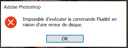

May 13, 2022
Bonjour, depuis la dernière mise à jour il m'est impossible d'utiliser ce filtre. J'ai désinstallé PS et réinstallé mais rien à faire.
Merci

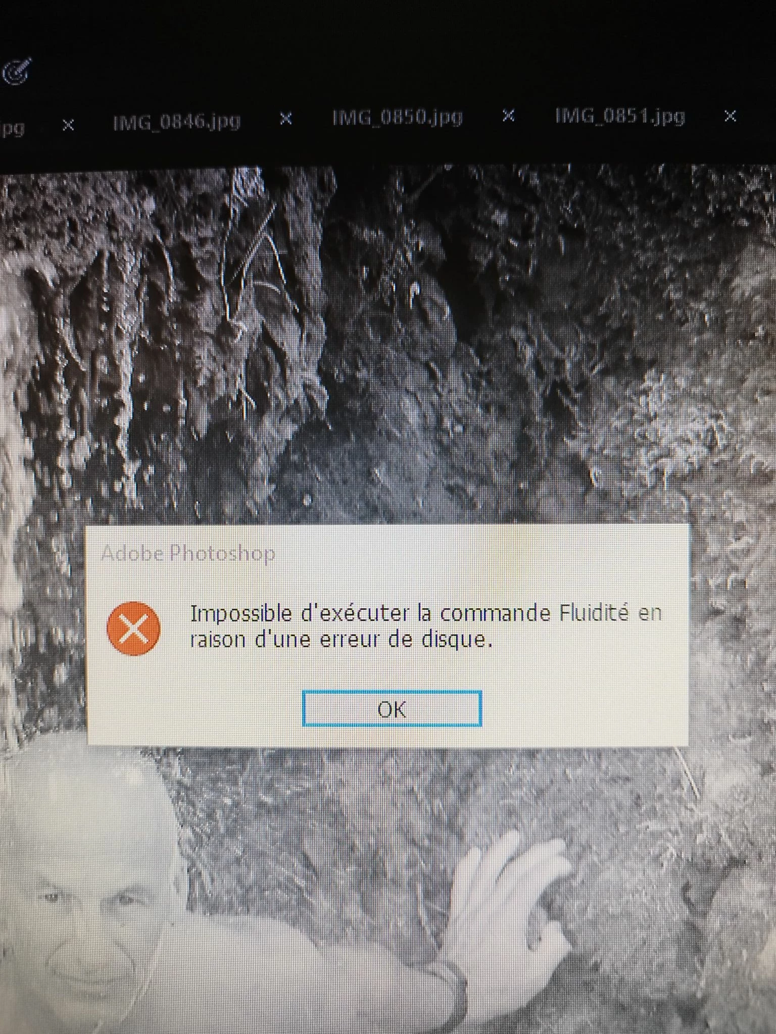

May 7, 2022
Hello everyone,
Since the last update, I can't use the "fluidity" filter. I get an error message about a "disk error"
I work on external hard drives, I took a new one but I still have the same message.
The other filters work, I work with a Mac OSX Catalina, version 10.15.7 (updated)
Do anyone of you have the same problem?
Thank you for your help,
Yves
Chris 486
May 7, 2022
Hi Yves,
Just want to check that photoshop has the access it needs to edit files on your mac. Have you checked your mac's System Preferences Security and Privacy, then go to files and folders and click on removable volumes. See that photoshop has access to removable drives.
