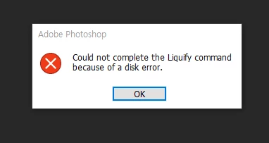

P: Disk error using Liquify
Não foi possível completar o comando Dissolver devido a um erro de disco. Essa é a mensagem que aparece quando tento usar o filtro Dissolver em qualquer foto depois da atualização 23.3
Quando voltei para a versão anterior funcinou perfeitamente.

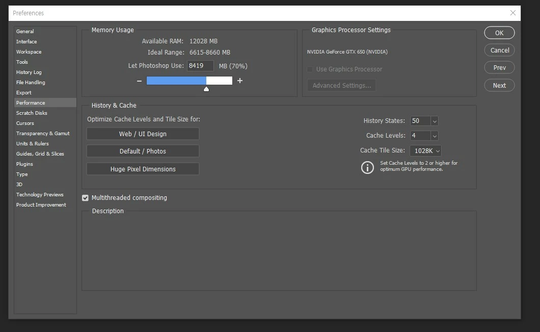

Go to Preferences > Technology Previews... and check "Disable Native Canvas" - then restart Photoshop. Does the problem still occur?
If this doesn't help, please disable the GPU completely.
Go to Preferences > Performance... and uncheck Use Graphics Processor. Restart Photoshop. Does the problem persist?

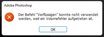

Hello!
Using Photoshop 23.3.1  (on a Windows 11 machine) I alway get an "volume error" starting the liquify tool shown in the attachment. Though some time ago this tool did work. And yes, the hard disk has plenty of free space as the cloud drive, too.
I searched for this issue but didn't found a solution - maybe I used the wrong keywords.
Can anyone show me a solution?
Thanks in advance.

Does turning off »Use Graphics Processor« in the Performance Preferences (Photoshop > Preferences > Performance > Graphic Processor Settings) and restarting Photoshop have any bearing on the issue?

Hello, I am testing the version of PS 2022 v23.3 and the updates are good, but it gives me the error "could not complete the liquify command because of a disk error" in the Liquify tool. In version v23.2 it worked perfectly, my laptop is a bit old but they did work.
Will someone have any solution?
The integrated card of my laptop is an old Intel graphics 4000.
Thank you ❤
