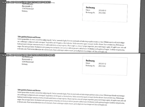

Like the title says.
Smart objects render badly (with jags) when being scaled or transformed.
There are stair-like jags on the edges and text looks like crackled.

Hello Every one it seems that the problem is back again in photoshop CC2017
I have trouble with resizing smart oject with transform compared to a rasterized layer
The transform preview is OK but the result is Jaggy !!
(The smart object itself contains only rasterized elements)
You have the same result when using "resize" and "export as" with a resize inside, "save for the web legacy" with resize inside go smooth ...
