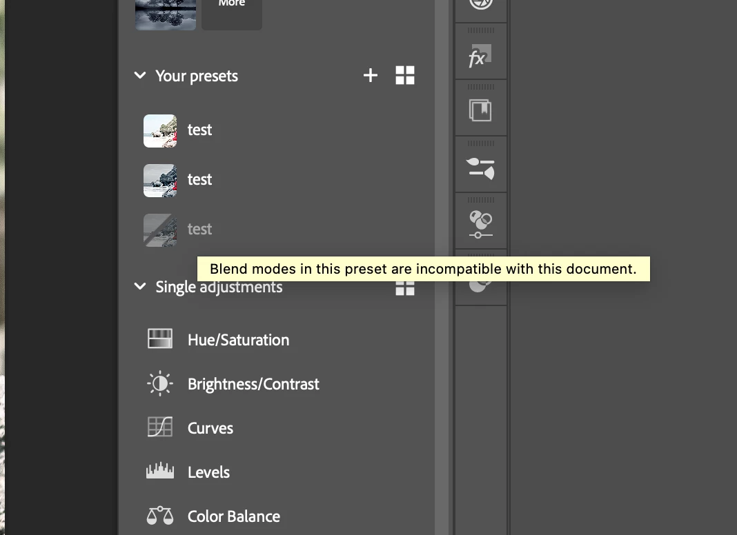

Apr 26, 2024 8:13 AM UTC
Adjustment Presets that use the luminosity blending mode are no longer working in the latest update of Photoshop (25.7.0). This is also true for the latest version of the Photoshop BETA. In addition to not working, presets created with the luminosity blending mode can't be deleted. When hovering over them, the tool tip claims the adjustment preset uses a blend mode not compatible with the document.

Jeff Arola
Apr 25, 2024 7:29 PM UTC
Some of the presets we've made use layer blending modes like Luminosity, which apparently aren't compatible with the 25.7 update.
So check if you've used any Layer Blending modes other than Normal in your presets.

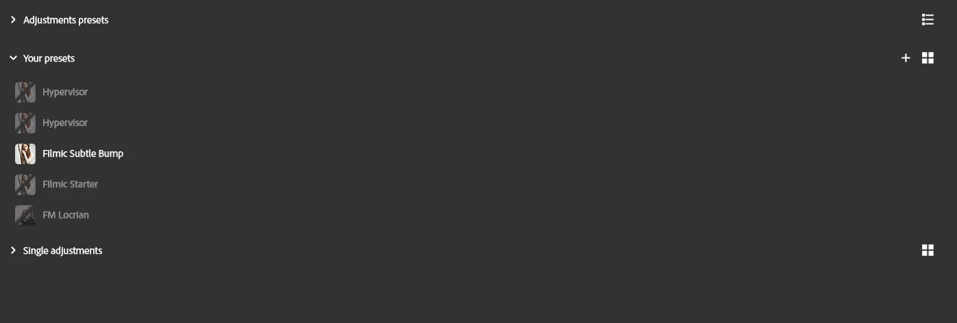

futuremotion6798557
Apr 25, 2024 10:20 AM UTC
I created a couple adjustment presets by selecting adjustment layers and then clicking the little plus icon:
For some reason that I can't discern - some of the presets that I created are grayed out and unusable. So I want to delete them (See the two "Hypervisor" presets in the above screenshot).
I can't figure out any way to accomplish this. How do I delete these presets?
And why are they grayed out?
Any help would be hugely appreciated as I love the idea of this feature but it's just not working well.
Thanks.
Jeff Arola
Apr 25, 2024 2:53 PM UTC
It seems with the Photoshop 2024 (ps ver 25.7) update some of the Layer Blending Modes used to create the Adjustments presets in previous Photoshop versions no longer work.
Here one of the presets i created uses the Luminosity layer blending mode is greyed out after the 25.7 update and the Luminosity blend mode no longer works when creating a preset and results in the preset being greyed out.
Did you use any layer blending modes in your presets that are greyed out?
futuremotion6798557
Apr 26, 2024 4:34 PM UTC
Yeah, that's it. When you hover over the grayed out preset it says that the preset uses incompatible blending modes. Which blows my mind because they are just very simple blending modes. Why couldn't the preset store that data?
Also there is still the problem of deleting presets. I can't figure out how to remove my grayed out presets.

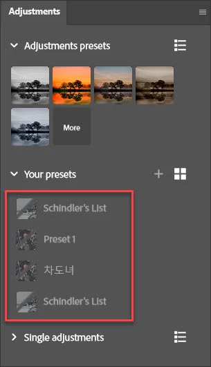

Apr 23, 2024 4:32 PM UTC
Two of my three Adjustment presets are "greyed out." How can I restore them? Any advice will be gratefully received.
