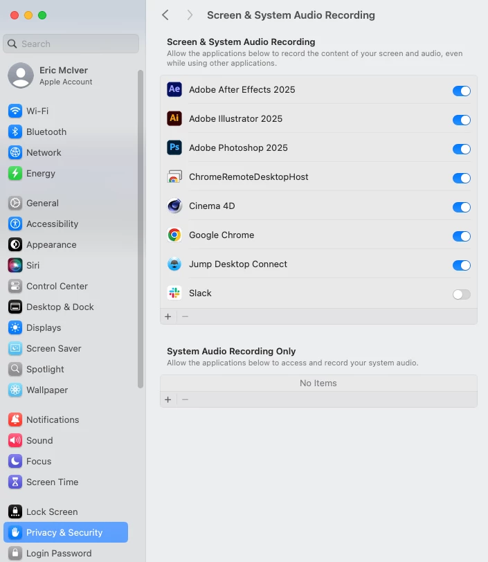

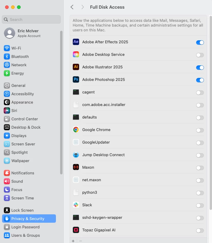

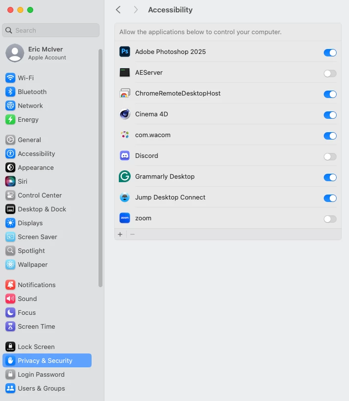

Installed the Beta, gave it all the permissions and it still does not work
Feb 24, 2025 10:50 PM UTC
All of these are turned on and it still does not work.
