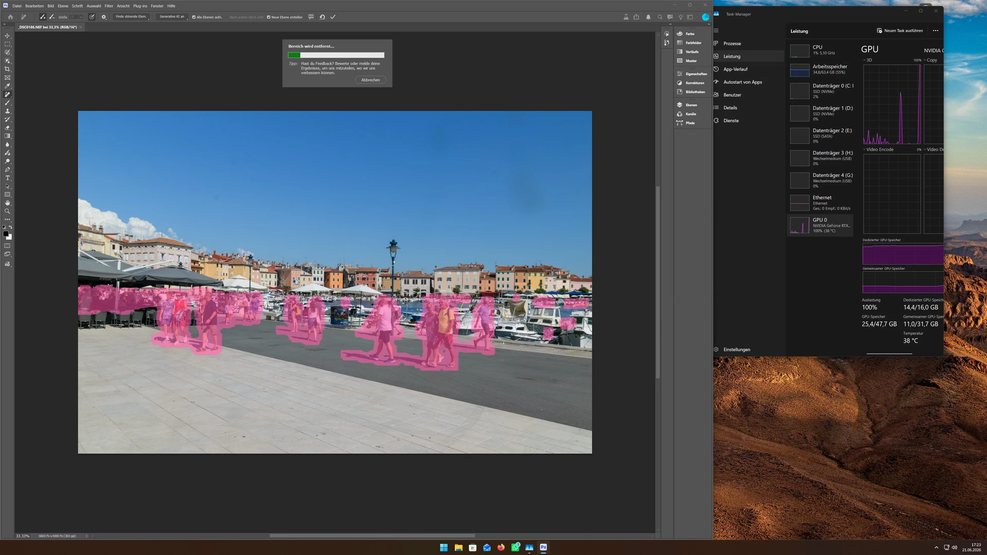

    Rockabilly Outlet
    Aug 9, 2026 9:37 AM UTC
    Here, it's exactly the same with an RTX 5090 and on a second PC with an RTX 4080. In fact, Photoshop actually crashed on the PC with the RTX 4080.
    As already described in this thread a month ago,
    it worked with the beta version (Adobe Photoshop Version: 27.9.0 20260616.m.3575 199f0a1 x64 (beta, PublicBeta) . Why it isn't working properly again now… Adobe, Adobe… 🤔

    Meanwhile on Nvidia studio driver 610.62 and Ps beta 27.10
    AI Removal tool uses GPU for selecting (goes very fast), but for actual removal it uses CPU (very slow).

    Yes, I got KB101650 installed, but I didn’t set my monitors to sleep.
    With every AI removal it activate the GPU to do the selection, while the removal itself is done by the CPU. So, even when I just did a removal on CPU, the GPU is used for all other functionalities like Topaz. So, it didn't go in low power state.

    @Matthias.G.ermany I noticed sometimes selection isn't perfect. Had to adjust the selection sometimes. But selection is run on my gpu.
    Removal not.
    Which gpu are you using?
