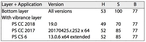

I installed Photoshop CC 2018 (Macintosh, Sierra v. 10.12.6) and I find that the colors displayed in a file are different than they are in Photoshop CC 2017. This makes it impossible for me to use Photoshop CC 2018.
I have a test file with two layers — an image and a Vibrance/Saturation layer. The file is in 8-bit Pro Photo. I have one color sampler in it (set to 5 x 5 in both versions of the program). If I turn on the Vibrance/Saturation layer, the colors are much less saturated in PS CC 2018 than in PS CC 2017. There are also small differences in hue. The following table shows the differences seen:
This difference can also be seen visually, and if you show out-of-gamut (CMYK gamut) colors the areas shown are different between the two programs. And, if you flatten this image, the values shown in the two versions of the Photoshop above are "baked into" the file — which means that the difference I am seeing is not a difference in reporting HSB values, but is a difference in interpreting a Vibrance/Saturation layer.

So, to finish this saga (thank you, everyone who contributed).
If change your working space in your color settings, the colors will be different (at least for this image), even if your image has an embedded profile.
My test image (linked above) is in Pro Photo RGB color space. If you open that image with your "working RGB space" as Pro Photo RGB, then the image will be more saturated.
If you open the same image with Working RGB space as sRGB, then the photo will be less saturated.
This difference follows through if you flatten the image. In either case, the flattened image will be saved in ProPhoto RGB (because I have "preserve embedded profiles" set for both cases). But the colors of the flattened images will be different. Here are the examples:
I had no idea that this is how Photoshop interpreted colors, but now I do. This issue has nothing to do with the version of Photoshop being used. I don't know where Photoshop saves its Color Settings, but it seems that it is not saved with the other preferences in the ~/Library/Preferences/Adobe Photoshop folder.
