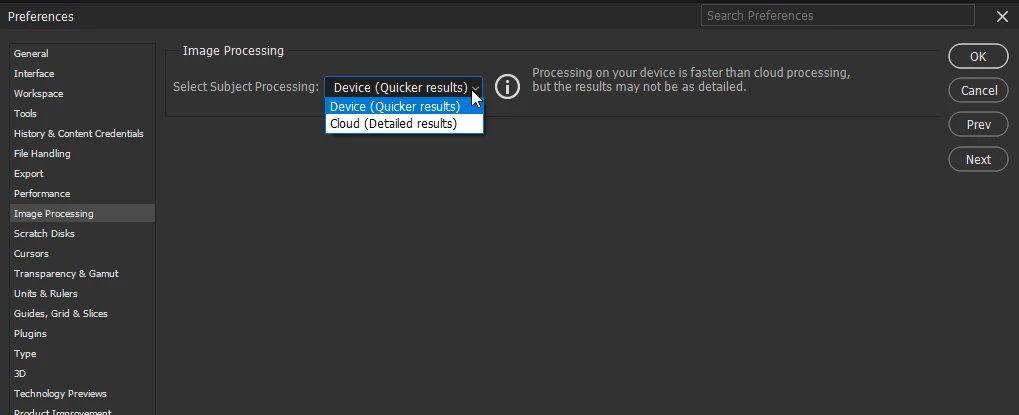

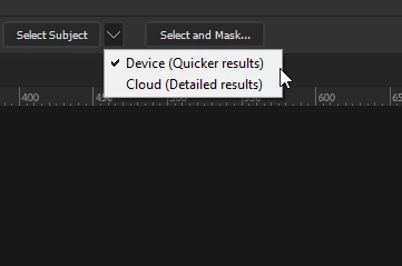

J E L
Sep 27, 2022 3:20 PM UTC
Hi @Yukie Takahashi, thank you for the update. Just to clarify, I'm running the 23.5.1 Release (Windows 10) and already have the option to select Device (Quicker results) or Cloud (Detailed results) in Preferences and on the toolbar. Is there something in the Photoshop (Beta) version that is different? Even with the latest NVIDIA Studio driver installed, Quick Selection is slower than previous Releases and there is very little difference seen whether selecting Quicker or Detailed.
I believe the OP and others replying are wondering if and when we can return to 21.0.3's Object Selection speed WITHOUT having to choose between the two. In other words, if it worked before, what has changed so that it now requires ticking either Device (GPU) or Cloud? Is your goal to gain more object selection learning through users who select the Cloud option? Again, we appreciate any clarification.
