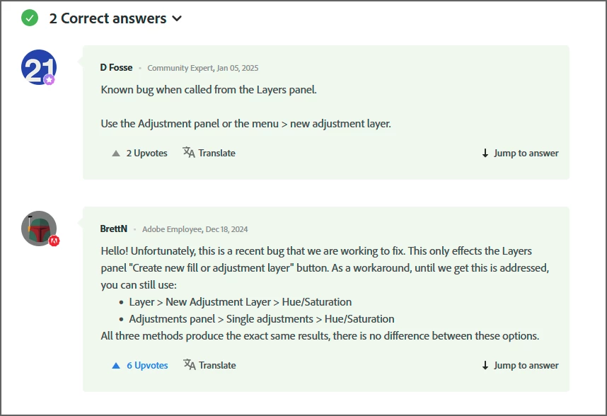

Look again at what has been marked as correct answers:

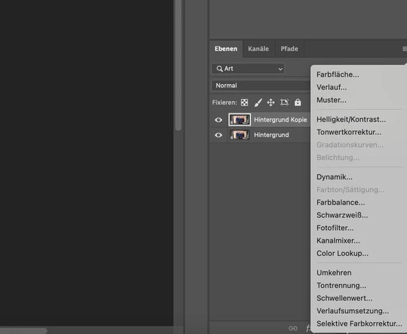

Jan 15, 2025 9:15 AM UTC
newest Update 2025: After Separation Gradation and Separation are not chooseable anymore only in the RGB mode

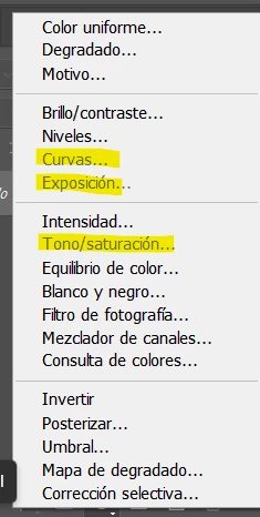

Jan 12, 2025 6:52 AM UTC
¿Porqué se desactivan estos ajustes de capa (curvas, exposición y tono-saturación) cuando estoy trabajando en nuevo documento?
Mohammad.Harb
Jan 12, 2025 8:03 AM UTC
it depends on the Document color mode ( image  -> mode ), all adjustments effects are availabel in RGB, However if you are in CMYK or Grayscale color mode some adjustments will not be availbe.

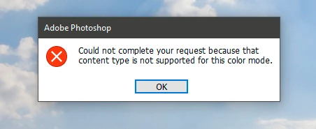

Jan 8, 2025 10:29 AM UTC
it is all mess as usually... on the other side, there are some adjustments, which are not greyed out, end up with error

@PierreGUT it's a known bug in version 26.2, you can use the workarounds until Adobe issue a fix
https://community.adobe.com/t5/photoshop-ecosystem-bugs/p-photoshop-26-2-adjustment-layers-grayed-ou...
