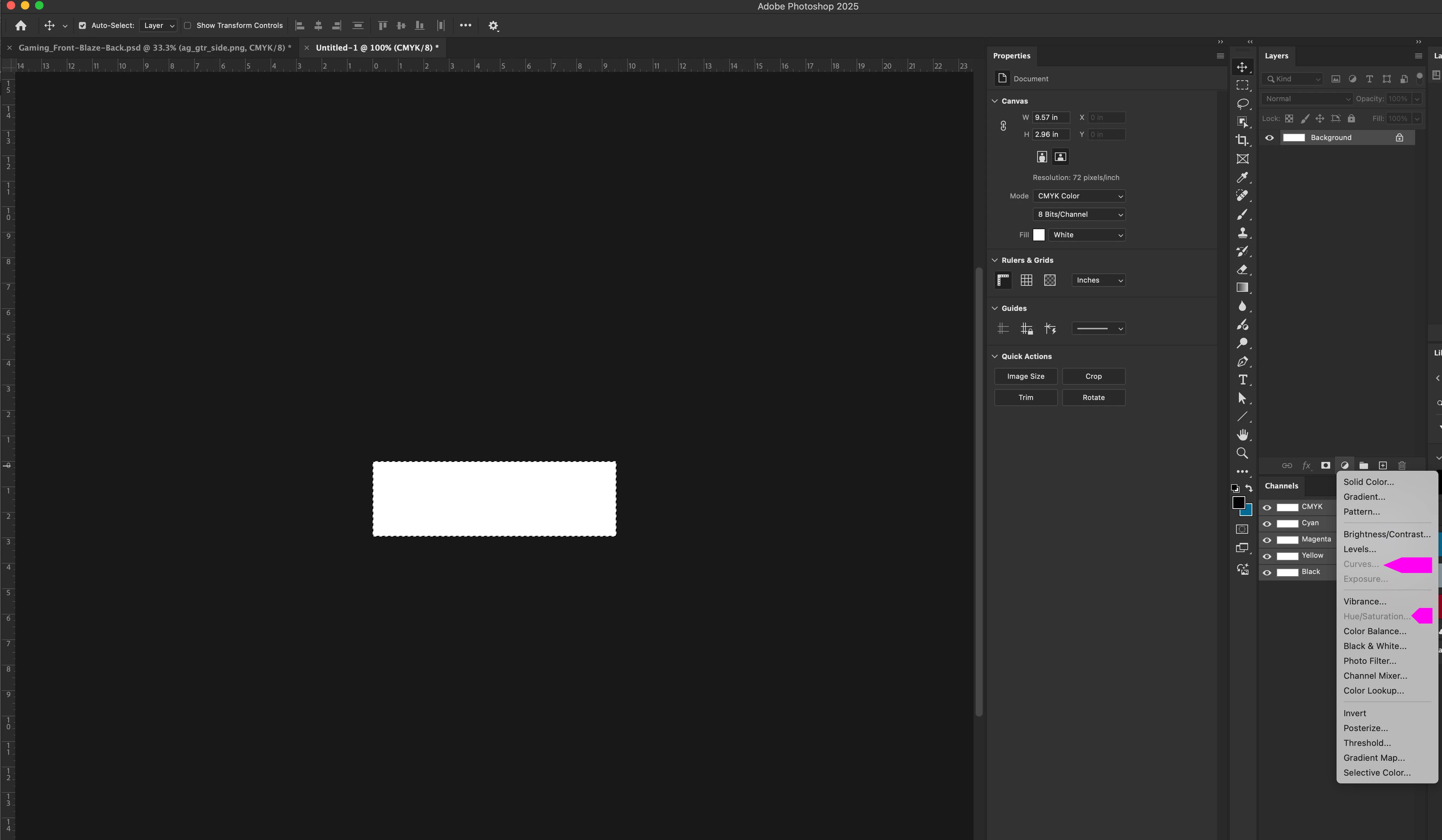

P: Photoshop 26.2 adjustment layers grayed out on cmyk file.
As subject states there are several adjustment layers that no longer work on 26.2 and beta.
Made a new file - CMYK 8bit filled a layer with color, attempted to apply adjustment layer and it is greyed out. Curves, hue saturation and maybe more.
I went back to 25.12 and it works as it should with no issues.
Windows 11.

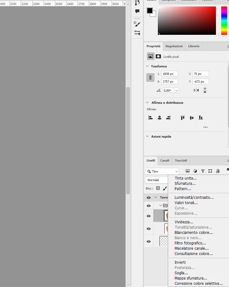

Hello everyone,
Here I want to report a problem given by the LAB color method. Before an update it was working correctly, I could use the curves, as well as the hue\Saturation.
With the new update it no longer lets me select the aforementioned adjustment options.
When you even click on Vibrance, it says that it can't be used for this color method.
Is it a bug or does the new update really look like this? because in this way I lose a lot in terms of processing.
How else can it be solved? Thank you
D Fosse
Jan 3, 2025 2:01 PM UTC
Known bug when adjustment layers are called from the Layers panel. Use the Adjustments panel or the menu Layer > New adjustment layer.

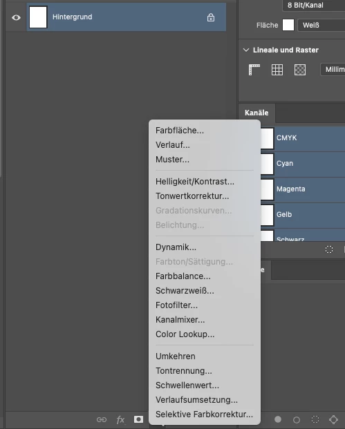

Jan 3, 2025 4:30 AM UTC
so in CMYK mode i can no longer create adjustments curves nor hue and Saturation adjustment layers. Why is that?

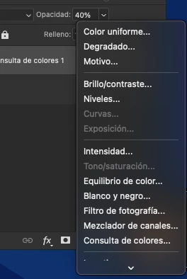

Dec 27, 2024 7:57 AM UTC
Hoy se actualizó Photoshop en el trabajo y ya no me permite crear una capa de ajuste de Curvas. Es necesario que sea ese el que use porque se tiene que dejar evidencia de lo que se le hizo al arte, alguien sabe cómo solucionarlo??
Ps 2025 (26.2)
Derek Cross
Dec 27, 2024 8:27 AM UTC
Consider resetting your Preferences, which you can do under the General tab in Photoshop Settings, then close and reopen the application.

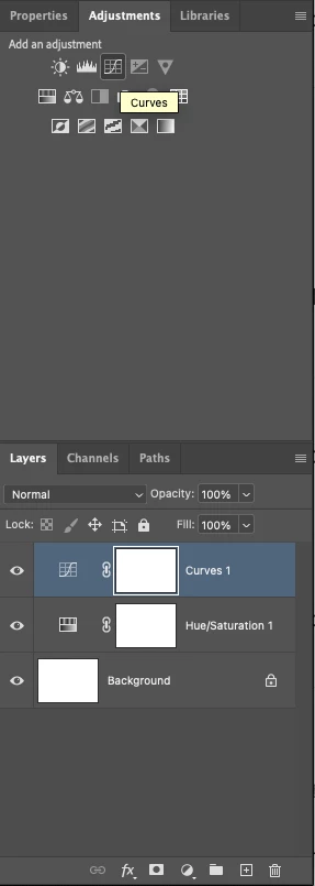

After most recent update of PS 2025, I notice that the Curves adjustment is grayed out, when accessing it from the layers panel. However, from the PS Menu, Image>Adjustments>Curves is available. Could this quirk be due to me running MacOS 13.7.2 Ventura? Yes, I need a new computer. Thansk for any help.
Jeff Arola
Dec 20, 2024 6:00 PM UTC
No not due to your computer or operating system, but a bug in Photoshop 2025 (ps ver 26.2)
You should also be able to access Curves from the Adjustments panel (Window>Adjustments)

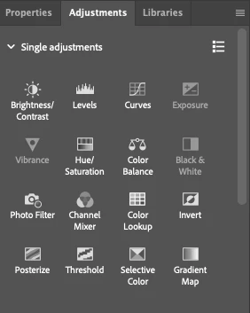

@Jen5FFC As you've seen, Adjustment Brush created the adjustment layer, and you can also create them within the Adjustments panel.
