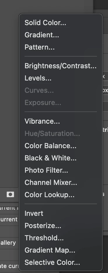

P: Photoshop 26.2 adjustment layers grayed out on cmyk file.
As subject states there are several adjustment layers that no longer work on 26.2 and beta.
Made a new file - CMYK 8bit filled a layer with color, attempted to apply adjustment layer and it is greyed out. Curves, hue saturation and maybe more.
I went back to 25.12 and it works as it should with no issues.

Hue/Saturation Missing in Adjustment layer in the latest update from photoshop. This is something we use regularly in CMYK mode to quickly modify colors. Why was it taken away? Is this something that can be brought back?
BrettN
Dec 18, 2024 5:28 PM UTC
Hello! Unfortunately, this is a recent bug that we are working to fix. This only effects the Layers panel "Create new fill or adjustment layer" button. As a workaround, until we get this is addressed, you can still use:
  • Layer > New Adjustment Layer > Hue/Saturation
  • Adjustments panel > Single adjustments > Hue/Saturation
All three methods produce the exact same results, there is no difference between these options.

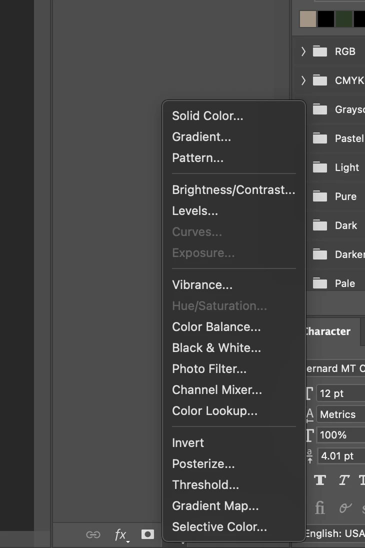

Using a Mac, with 8bit CMYK files on a regular layer - either on existing or new files, the Curves/Exposure/Hue Saturation is greyed out in Photoshop (layers pallette) suddenly... no idea why - Photoshop 2025 (latest) AND also the Beta version - help!

Below is a link to a screen grab video of what I experienced.
Adjustment brush tool works apparently but not adjustment layers via layer panel. Also tried switching to a different tool thinking maybe the new adjustment brush tool was causing the isssue but it didn't make a difference.

Hi @Jen5FFC ,
Thanks for letting us know this made it to the release version and apologies for the trouble here.
We've been able to reproduce this as well and will work on a fix for this.
Workaround: We're able to create Curves and Hue/Sat adjustment layers via the Adjustments panel and Image > Adjustments.
Could you check that out and let us know if it's the same for you?
Pete

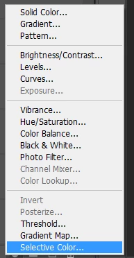

In 26.2 the option to select an Exposure adjustment layer has been greyed out. Surely this is a bug? I'm able to duplicate existing Exposure layers but not create new ones.
Working in RGB/32bit mode on Windows 10.

Dec 17, 2024 11:37 PM UTC
All adjustment layers work in CMYK here, on 26.1 - with three exceptions: Exposure, Vibrance and B&W.
Exactly the same on v25.
