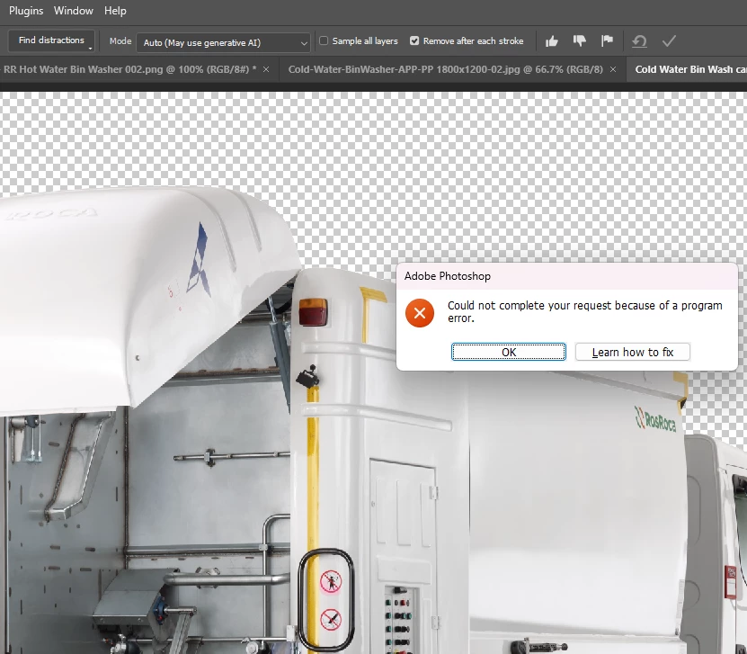

Jul 3, 2025 9:04 AM UTC
Hello all, I'm posting this here in case it's helpful to anyone else as I've spent quite some time in the past 2 days trying to get it sorted.
Remove Tool will throw error "Could not complete your request because of a program error" on the current and previous Photoshop versions (at least) on Windows 11 (at least) when these conditions are met:
  • The image is an object against a transparent background (I have not tested whether a single transparent pixel is enough to trigger this) (it does happen even when the transparent pixels are nowhere near the area you're using the Remove Tool)
  • The Remove Tool is set to "Auto (May use generative AI)"
These conditions cause the error to happen 100% of the time in my testing. However, if the image has some transparency but the Remove Tool is set to either Generative AI on OR off, it will not happen - only Auto. If the tool is set to Auto but there is no transparency the error will not happen.
So if you are getting this error intermittently as I was and you are feeling frustrated, I hope this helps. I have reported this to the Support team but I doubt there is anything more they can do for me, I just hope it's fixed in a future version.
In case it's helpful to those teams, this is how the logs look:

@shannon_3880 just tested on my system, and I was able to replicate the issue
Sameer K
Jul 3, 2025 11:15 AM UTC
Thanks for adding the details. I've also recreated this and merged similar reports. The team is investigating this now.
