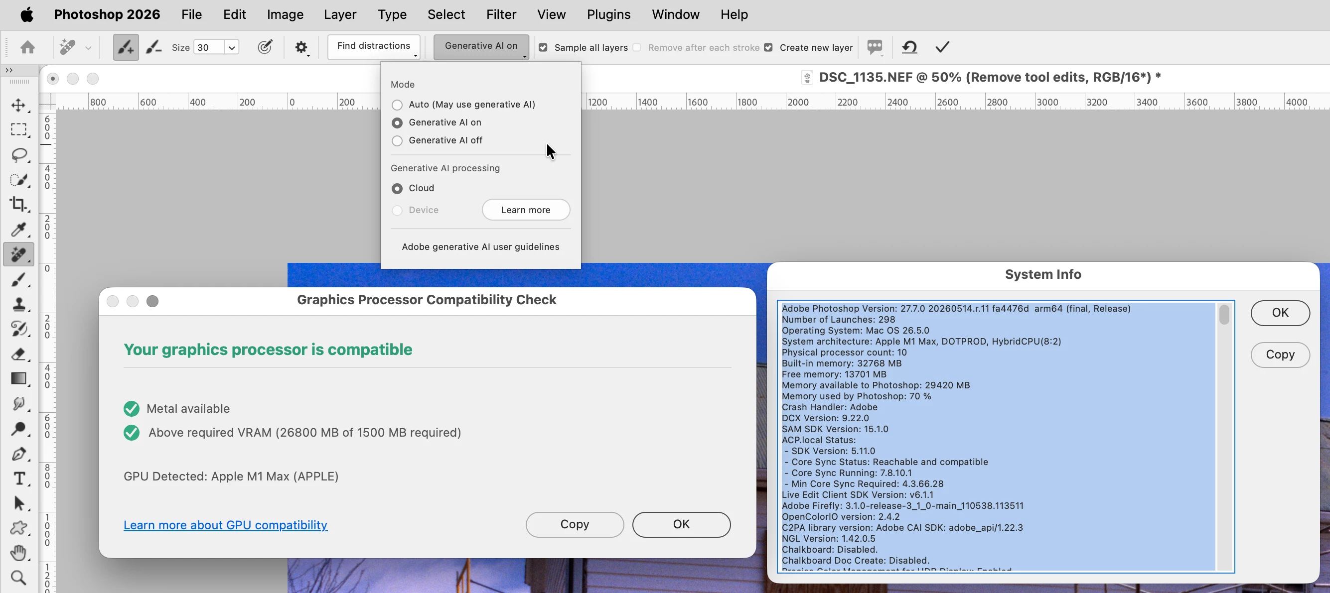

    June 8, 2026
    Hi — I am having the same problem: I have a Macbook pro M4 max with latest version of PS and for the last few days the Remove tool in Photoshop (desktop) has become very slow and frequently shows a "check your internet connection" error, even though my connection is fast and stable. The generative part of the tool keeps failing or dropping to non-generative mode. I've already ruled out my network.
