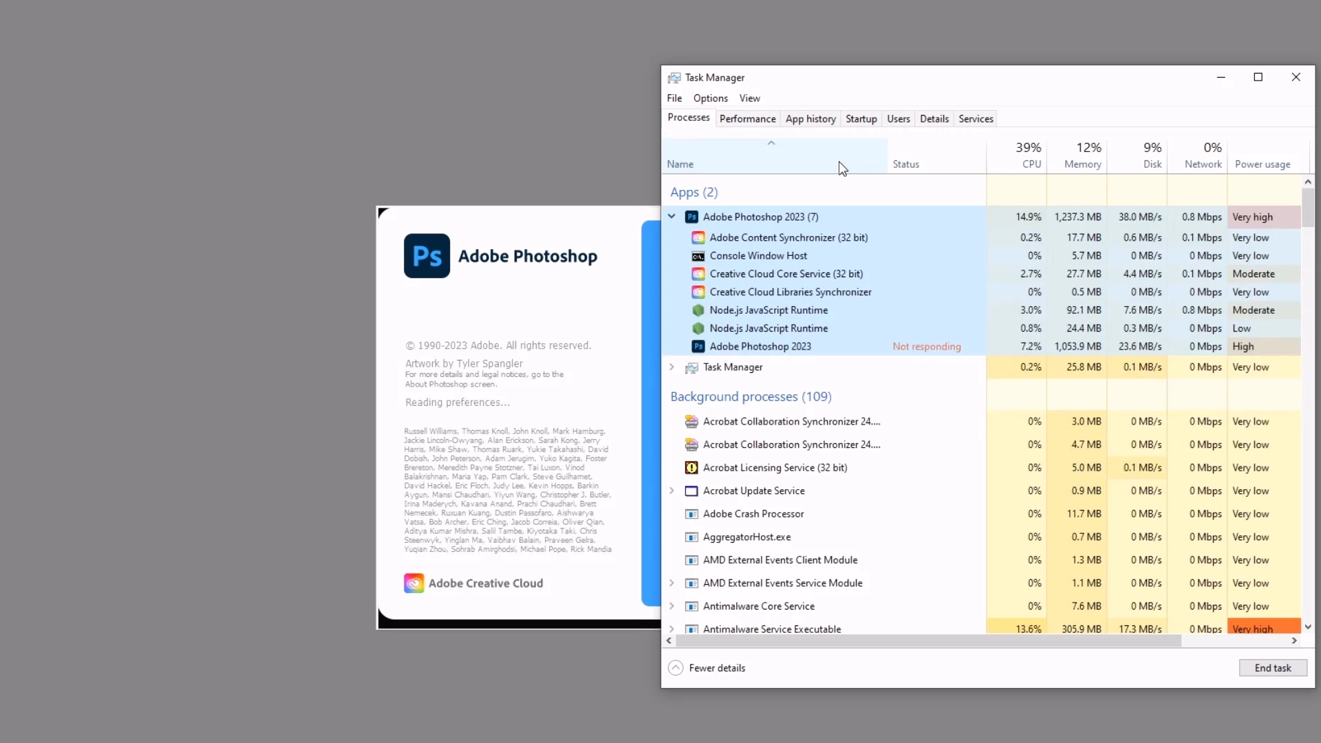

Aug 6, 2024 2:39 PM UTC
When i open Platform PS n PS beta, it's holding in "reading preferences", no answer.
uninstall PS and PS beta, also holding in "reading preferences"
how can i fix? Thanks
