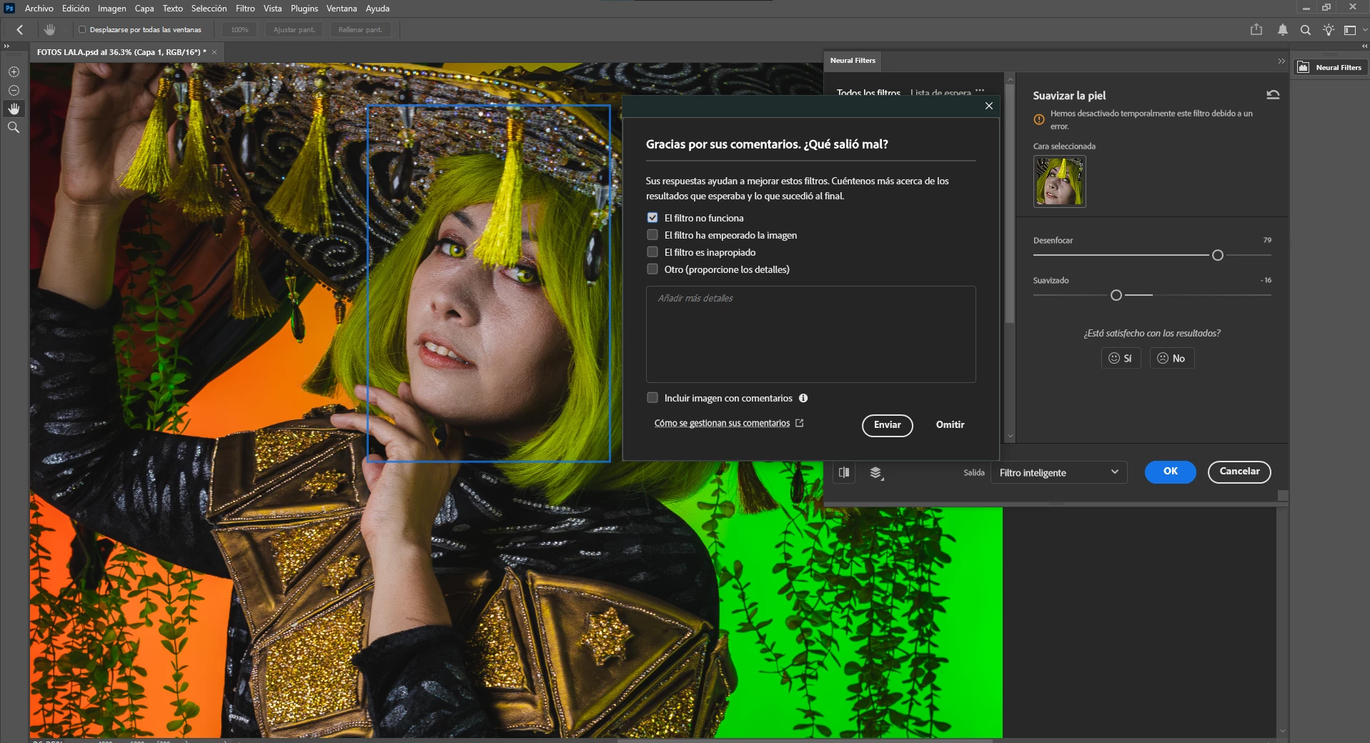

Oct 18, 2025 4:49 PM UTC
I was working fine and suddenly all Neural Filters stopped working. Error message:
"Hemos desactivado temporalmente este filtro debido a un error"
Oct 18, 2025 6:05 PM UTC
This error means the Neural Filter feature has been temporarily disabled by Adobe due to a bug. Try restarting Photoshop, checking for updates, or signing out and back into your Adobe account. If the issue continues, wait for Adobe to fix it in the next update.
