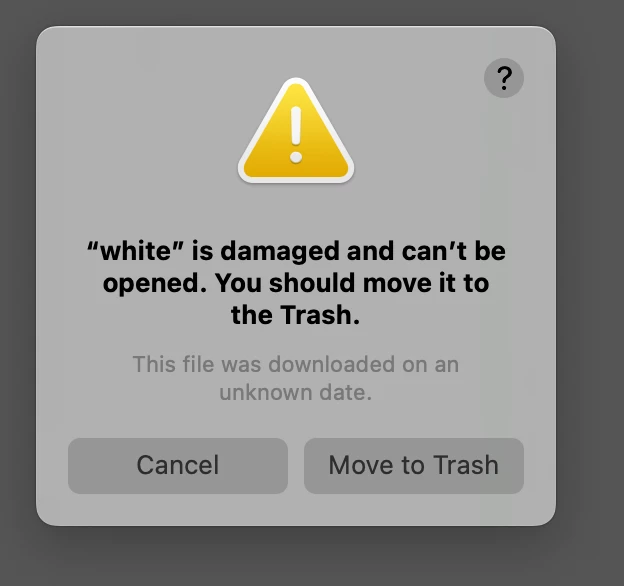

I'm also having the same problem with droplets. I have done System Settings/Privacy & Security/clicked Open Anyway...nothing happens, still get error message.  I have also done System Settings/Privacy & Security/Full Disk Access/turned on droplet.  Neither of these work.  Does anyone have a fix to get droplets working? I'm working on 26.5.0
Apr 18, 2025 6:35 PM UTC
Running Photoshop v25.6.0 on a Mac Studio M2 MAX,  macOS v15.4 with same problem everyone else is having.
After spending HOURS troubleshooting this it would appear to be a "known issue" that you are working on, so I await the next release which hopefully has resolved this issue. As a side not, I don't even get an alert in the "Security" subsection. All possible privacy and security prompts are enabled, and I even reloaded PS using Shift/Option/Command to no avail other than wasting my time. PLEASE ELEVATE THIS ISSUE as a higher priority on your list for engineering to address ASAP.
